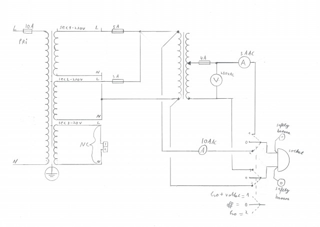

simple questions regardin isolation transformer and variac combo.
Just a small after-words, i noticed today when i plugged this on my lab, that it takes a LOT inrush current. My desk lamp dims breifly pretty much, and what i read about toroid transformers, this size transformer can take enought inrush current to trip fuse. Gonna need to get/design inrush current limiter. maybe some other way than switch in parallel to lamp...suggestions welcome, for now that is, project 'aint done yet .
hmm, what i know, they are slow-blow. Didn't thought about that, so inrush current shouldn't be problem?
edit: yes they are indeed slow-blow
ah, thanks i did find some information, but for now, this might not be issue, as no fuses are blown (yet...)
Hey Fez:
There is one thing that you need to correct ASAP. When using a Variac, the output or wiper HAS to be fused. Lets' say its rated at 2400 W with 240 input and you fuse the primary at 15 A Slow blow.
Now you set the output to 10 V and try to draw 24 A from it. That's 240 W, In this case, the transformer wire will melt. 14 IA >> THAN 10 A,

Fix the fuse location in the circuit!
Datasheets for Variacs will show the wiper fuse.
hey keepitsimpletupid, i did install the fuse at wiper. i was aware about it before, but thanks anyway, you cant be too careful with ''mains'' voltage even isolated.
killivolt, i'll post schematic today, right when i draw it ''clean'' as it now is pretty, well fussy. it got little moisture when i was doing this thing outdoors.
ok, heres the schematic. sorry about the quality, i drawed it on paper, then scanned. I'm too oldish to use computer softwares....i just like more to draw these at paper .
OK, at this point, isn't the circuit working? The question you asked in post #21 was addressed in post #24. That is, if you want to stop the lamp from momentarily dimming, use an inrush current limiter.
Is there another question?
John
yes the circuit is working just fine, inrush current just got my attention, so i figured maybe there is something that should be done to it.
Inrush current is just one of those things that happens when you attach a big inductor. Motor starting, like a furnace motor, will do the same thing. I wouldn't worry about it, so long as nothing else is adversely affected.
Regards, John
