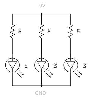

If your powering LEDs (or any device) you dont add the voltage drops, you can power them on a single supply rail (like a single 9V battery).
See attachment.

See my attachment.
Cool, that makes sense. How would I determine what resisters to use on each one? I have 10 LEDs (1.7V,20mA) and an input of 18V. Thanks!
