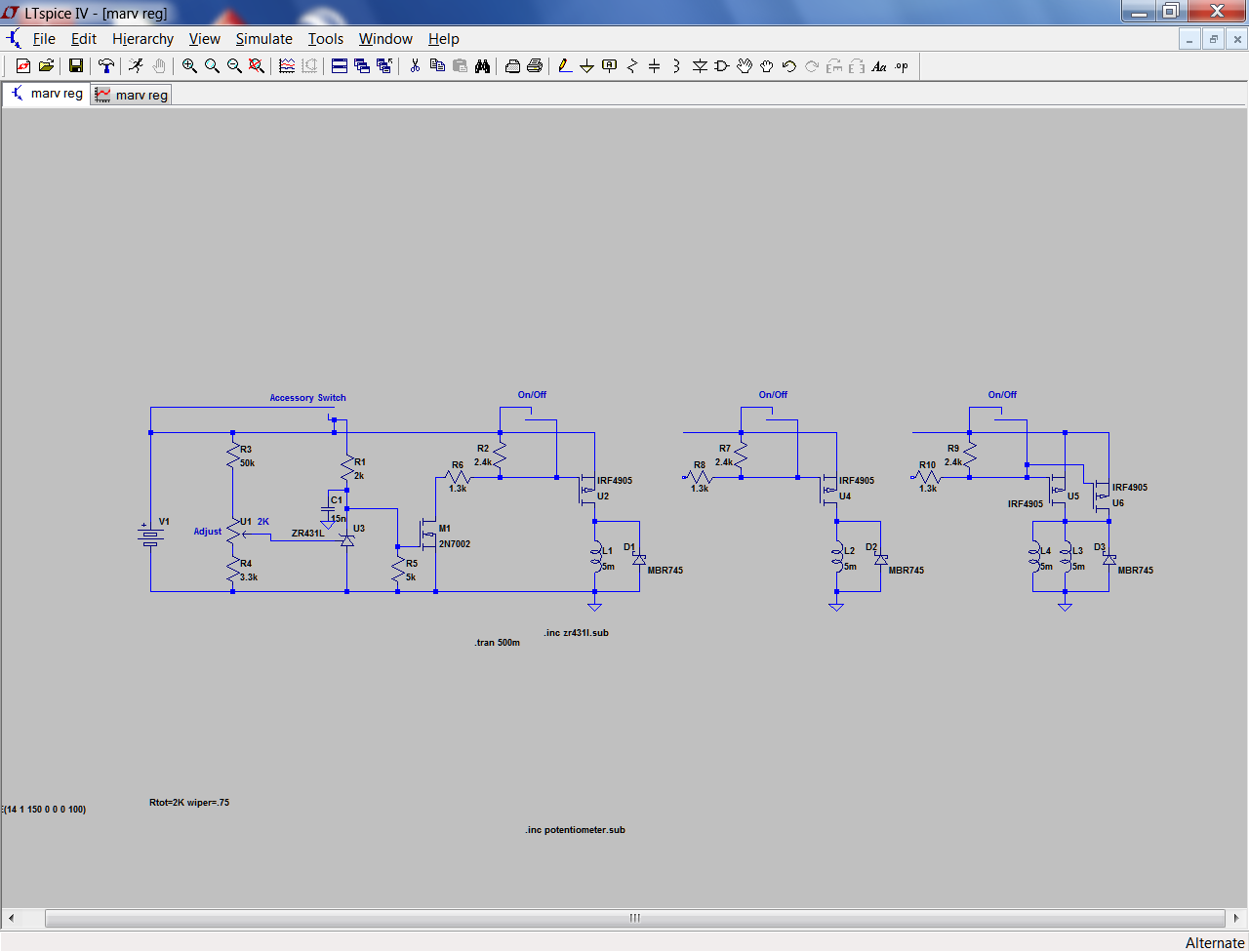

OK. So after talking with Chemelec I came up with this one based on an adjustable voltage reference.
The reference supplies the adjustability as well as acting like a comparator to sharpen up the turn on/off voltage. The cap on the regulator insures stability as well as making the maximum switching frequency some reasonable frequency. The 7002 inverts it and allows for the multiple alternators to be turned on and off.
The gate resistors make turn on/off kind of slow which hopefully will reduce EMI.
I'm looking for inputs in case I have it all wrong..

I've run a sim of that circuit but I'm not seeing any regulation or PWM effect. U3 does not have a zener-like effect. The voltage across U3 simply follows (albeit with reduced amplitude because of the R1/R5 potential divider) the V1 supply voltage, so M1 stays conducting unless that voltage is very low (the M1 turn on threshold), and it does not switch cleanly.
Can you clarify the intended circuit operation?
