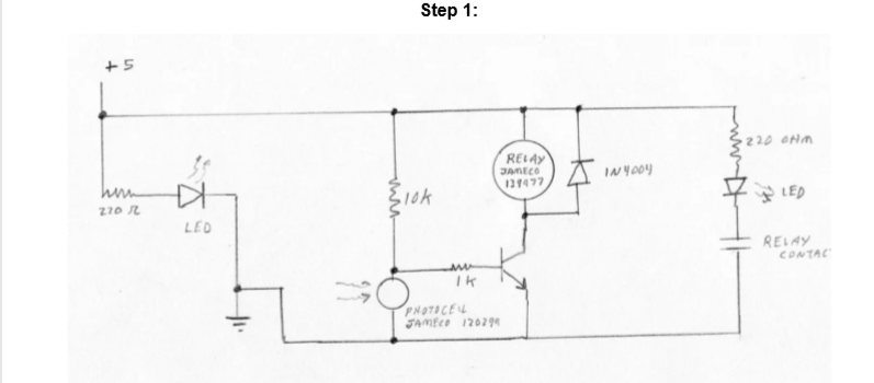

Hi
Am making a light break detection sensor as per attached schematic.
Question: I can't find a 5v relay with a coil resistance of 125 Ohms, I have some 5v relays at 70 Ohms would they work ?, also the diode 1n4004 , I have some 1N5397 would they do in place of the 4004 ? .
cheers
Spike

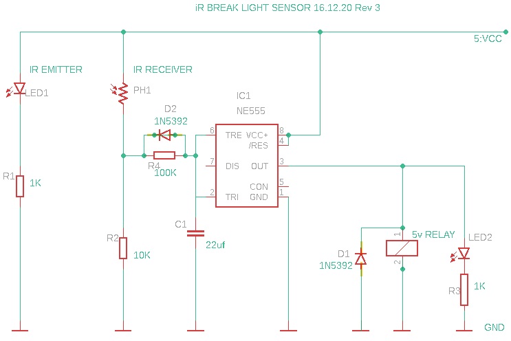

Hi again
Is there some way to introduce a time delay into this circuit, so that after the object passes through the beam break the relay will stay activated for lets say a second later !.
cheers
Spike
Yes. But your question is ambiguous. Do you want the relay delayed or the activation to be extended?
Hi
Thanks for your reply, sorry if not been clear, "activation to be extended" is what I would like to do .
heers
Spike
Here is what I have as a schematic by (dodgydave)
