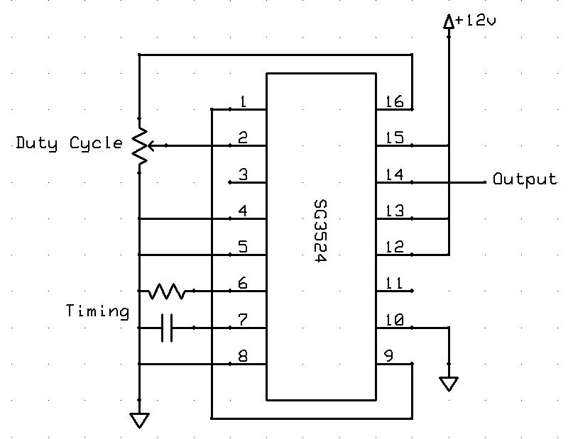

Alex, I looked up a data sheet for the chip you mentioned and the cost seems reasonable. How is it hooked up and what other components are required?

You are going to need a potentiometer to control the duty cycle and a capacitor and resistor for the internal oscillator.
Use pin 14 as the output to the LEDs or use it to drive a larger power transistor depending on your power needs.

A555 is far simpler and far cheaper for such a simple application, it also has half the pin count/size
