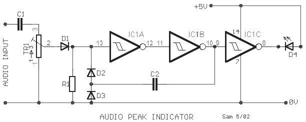

Signal amplifier using CMOS inverter
Diode detector using CMOS inverter
Schmitt trigger using CD40106B Schmitt inverters or use two CD4069 with R ratios to act as Schmitt with hysteresis.
This is one of many ways.
MOSFET after CMOS to drive LEDs with suitable 10x current rating.
CD4049 chip.

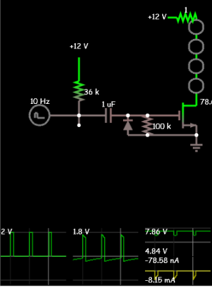

THe simplest possible might be this.
Using R= 36k V+=9V C= 10uF with diode shunt to clamp negative voltages. and a 100K R to ground to a Nch MOSFET Gate
Electret Mic below with 2 external parts using 36K should be able to create >1V peak with mic attached to pedal drum. Polarity of pulse needs to be verified by checking sensitivity of mount vs inverted mount, but in any case , pulse will ring so either polarity will work.
THis MOSFET comes in SMT only but triggers from 0.9V and can easily switch 2 amps. You would replace your transistor with this one and use diode clamp with mic out to series cap with 100K to ground on gate to source.
a simple result as follows.
