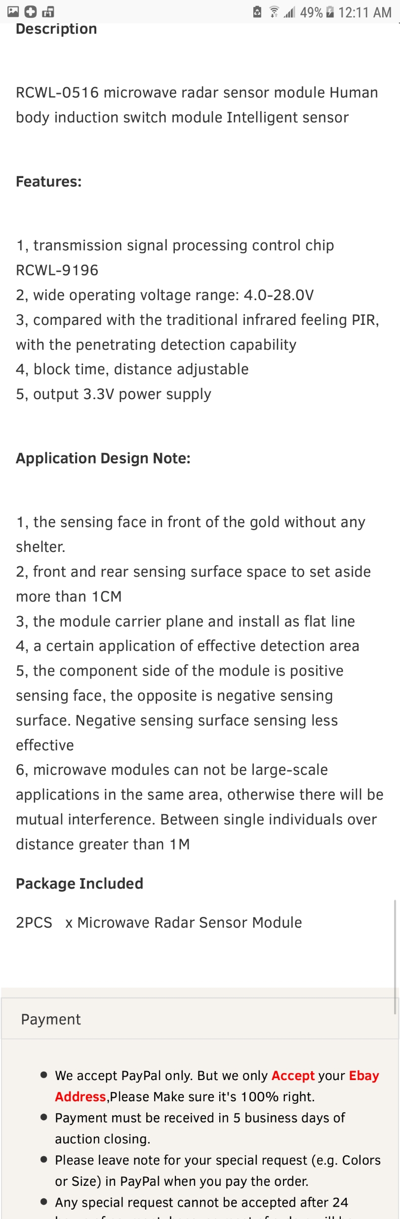

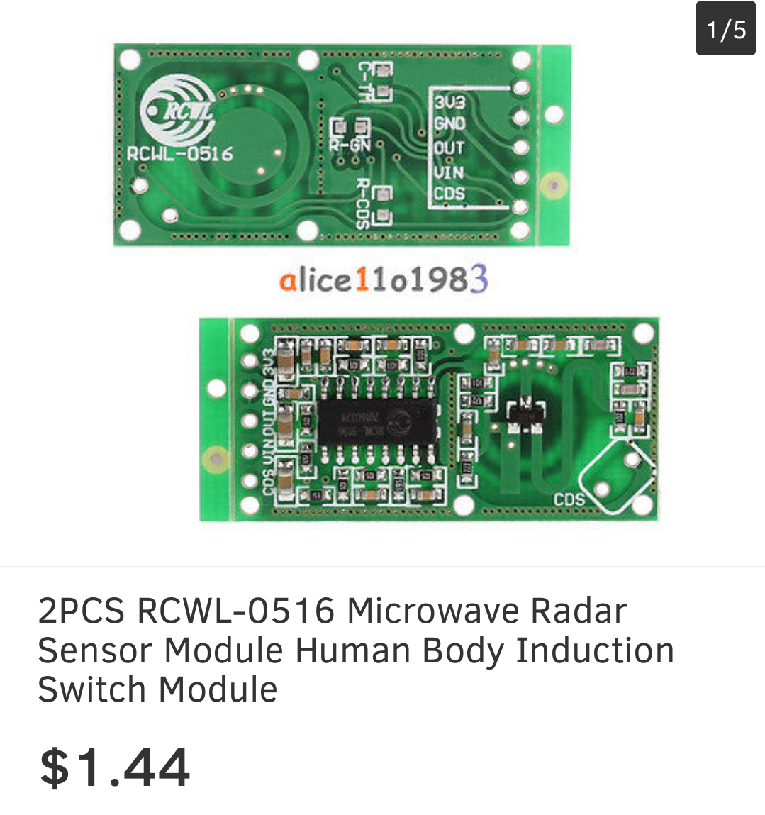

Try these "radar" sensors. They will detect people at 5 meters (which can be decreased by adding R or C), they will detect people THROUGH walls, they are cheap, small and easy to use.
They are about 1" × 2" and will work over a large voltage range. You will need to use a transistor to switch any current.

The radar sensors are ridiculously easy to use. I connected power (to the Vin terminal, not the 3.3v OUTPUT) and a DVM to monitor the output and it worked straight away. It detected my partner coming down the stairs through 2 layers of sheetrock, a layer of wood paneling, even with various soldering stations and etc. in front of the wall. The ONLY difficulty is that they provide only about 2mA output, so a driver transistor will be needed for almost any application.
