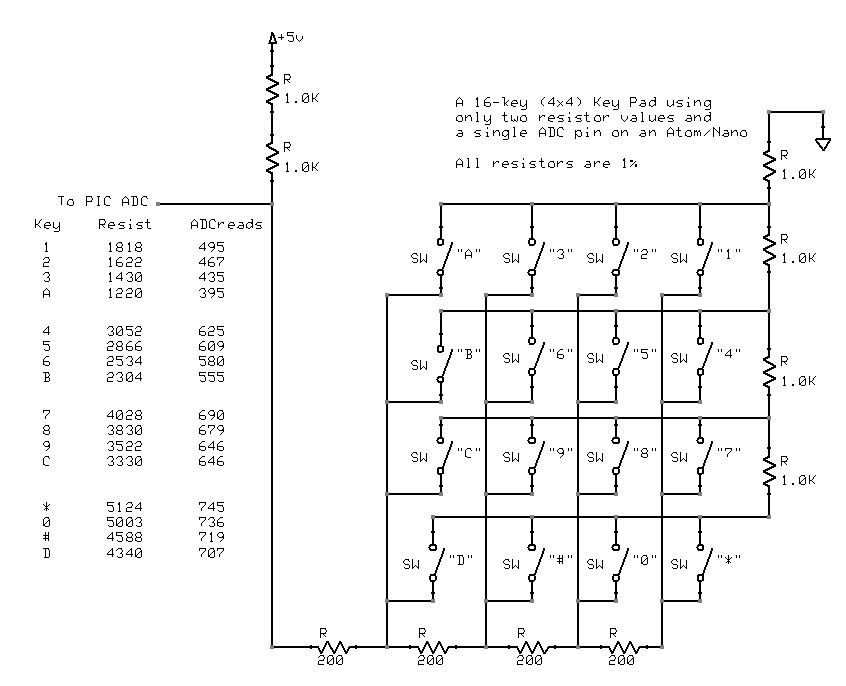

Back to it: I breadboarded that voltage-divider keypad and had an Aargh! moment.
Thanks to real small spread between keys on the lowest row (*, 0, #, D), key press resistances bobbing around from 25 Ohms to 45 Ohms, and 5% resistors, my "0" and "#" keys had identical values. I triple-checked the wiring, and found a mistake, but it still had the same problem. So I have to rework the resistor values to get larger ADC increments between keys and try, try again.
But the basic idea still holds true. You can have multiple switches (read: keypad) connected to a single ADC pin and figure when one was pressed and get a value that determines which was pressed.
Later!
The trick is to use much larger resistance on your external resistors, so the <60 ohms of the keypads is insignificant. If your voltage divider is in 5k steps then it won't even notice a 60 ohm difference.
This time for sure
It finally dawned on me to grab some precision 1% resistors from work and revisit this keypad-to-ADC-pin project again. This time I'm using 200 Ohm resistors instead of 220 Ohm resistors. This gives me more "space" between ADC readings.
Attached is the latest JPG drawing of the circuit. This drawing includes the measured resistances and measured ADC readings for each key. It is evident there is plenty of "space" between ADC readings for each key. Which is a good thing, because some of the key switches on this cheapo Ebay keypad make lousy connections while pressing and cause widely varying readings. The extra "space" allowed me to use very forgiving values in the conditional routines to determine which key was pressed at the time.
So, it works, even with sloppy switches, and here is the drawing:
