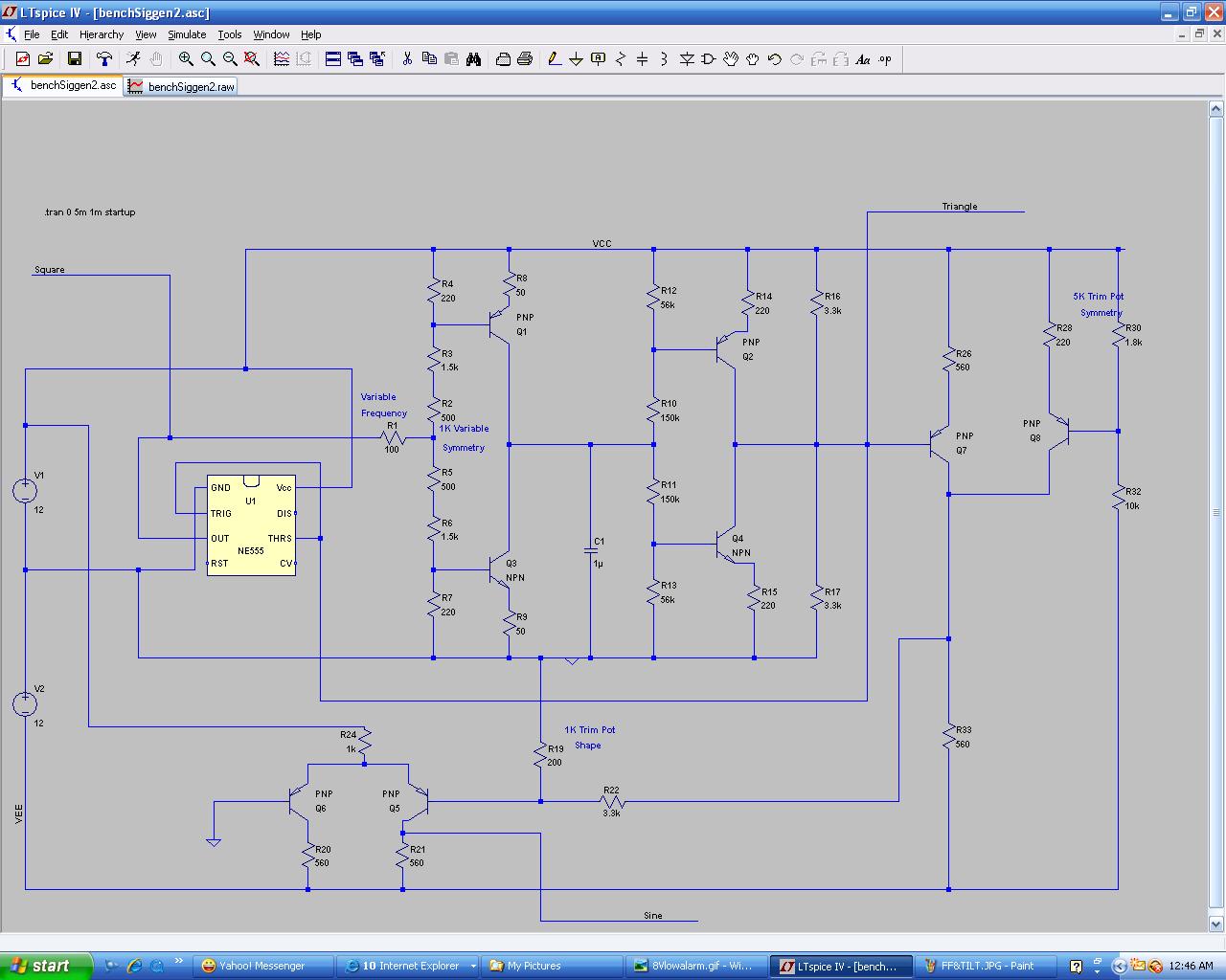

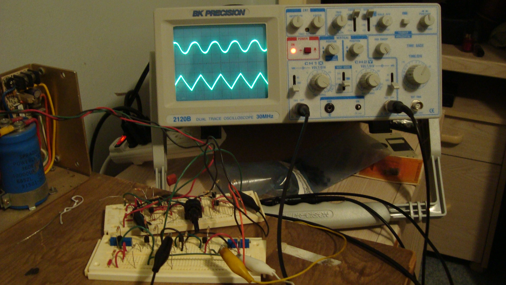

Some might remember this one I've discussed here. I got around to building and testing it some time ago. It works great, up to about 500KHZ. ( I hope to get 1MHZ when it transfer it to a better board. ) I was a little concerned about the level shifting network for the final sine wave shaper, but it has been very stable. It might look complicated with all those transistors, but it's really very simple. The reason I wanted to use transistors was because of thier ability to take a lickin' and keep on tickin', and because I wanted to breadboard the design and not deal with opamp's weird breadboard behavior.
The weakness is the frequency isn't really adjustable. I change it by changing the timing cap.

That circuit looks familiar.
I wonder how my ideas using a few op-amps matches up to it? I suppose it depends on the op-amps.
Yeah, I hadn't built it when we were discussing it. I have a few op-amp sig-gens I've built too. But I just wanted to use BJT's for this one. Also thinking about replacing the timer chip sometime in the future.
