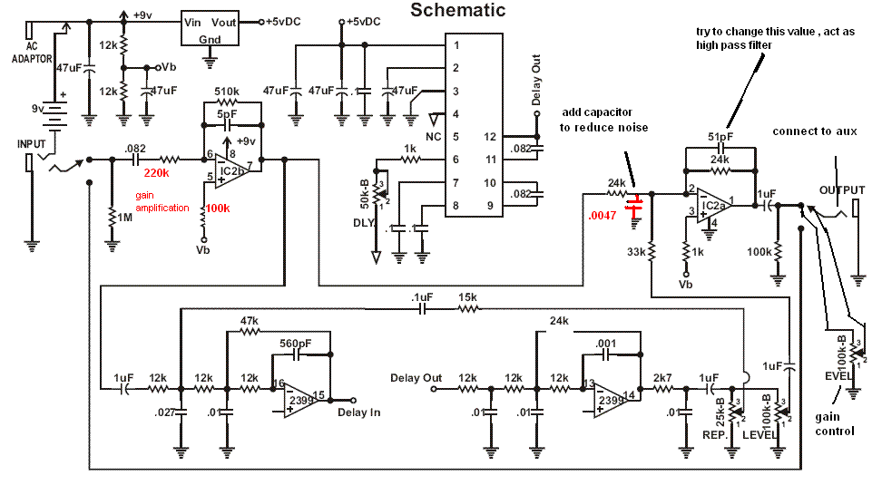

That circuit uses the 10k input resistor to power an electret mic. The circuit will work with a dynamic mic if the 10k resistor is removed.
Thanks for suggestion,
audioguru said:
Use a TL071 single opamp instead of the TL072 dual opamp. Its pins are different, see its datasheet.
I thought of combining this circuit outputs ( in parallel ) and connecting them into input of reverb circuit !? is that wrong ?:o
audioguru said:
Use a mixer circuit and more preamps if you want more than a single microphone.

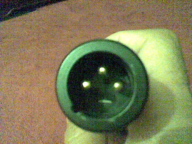

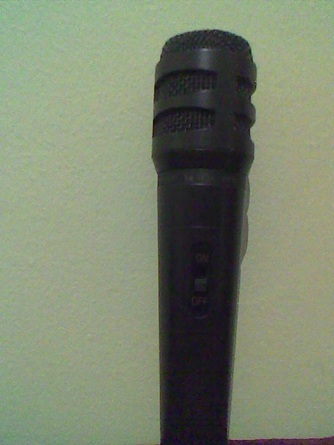

Nigel Goodwin said:
What make is the mike?, and what type of connector does it have?.
attaced are two pictures of the used MIC. it is moving coil TOA DM-1200. 600:ohm: .

aljamri said:
I thought of combining this preamp circuit output ( in parallel) and connecting them into input of reverb circuit !? is that wrong?
One preamp's output can connect to the input of the reverb circuit. If you have more than one microphone then each one needs to have its own preamp.
You cannot short the preamp outputs together, they must feed the inputs of a mixer circuit that feeds the reverb circuit.
It is very simple and attenuates the signals. You need a mixer made with an inverting opamp.

attached are two pictures of the used MIC. It is moving coil TOA DM-1200. 600:ohm: .
I was right!
Told ya so. Told ya so. Told ya so. Told ya so. Told ya so. Told ya so. Told ya so. Told ya so.
Make a video of the smoke.
I am very new to AUDIO stuff, do you mean it is not good, i bought it for more than $50 ? if so what type do you suggest for me ? not for the best, but what will give better than this ( only for voice and not for music ).
Your TOA microphone is fine. It is balanced with an XLR connector so buy a matching XLR jack and wire it as unbalanced if your cable is a couple of meters or less short length.

He doesn't have a preamp. He has this reverb circuit that has a gain of only 1.
If its input is non-inverting then I would increase the gain of the first opamp so it is a preamp.
aljamri said:
No, it is connected into MIC input. I tried AUX once but sounds very low.
It needs to plug into the AUX input (or at least a guitar input), as we keep telling you, add a mike preamp BEFORE the reverb/echo circuit to get to the correct signal level. This is what is causing ALL your problems, not using it correctly.
look at your circuit there's no gain control, audio coming from (input) ic2b then out to ic2b going to resistor 24k then going to input(ic2a) then out ic2a output directly connected to you mic input . which means that signal are to high for mic input, all noise will be amplified generated by opamp. level (100k) controls a reverb section.
like nigel said, you need a preamp, if your going to connect your reverb to aux .

The signal from the mic is too low for this reverb circuit which normally has line level signals at least 60 times higher. So the noise from this circuit is amplified at least 60 times by the mic preamp that it feeds.

" look at your circuit there's no gain control, audio coming from (input) ic2b (tl072)then out to ic2b(tl072) going to resistor 24k then going to input(ic2a) then out ic2a output directly connected to your mic input(pa amplifier) . which means that signal from the reverb(opamp) are to high for mic input(PA amplifier) , all noise generated by opamp(TL072) will be amplified by mic input(pa amp). level (100k) controls a reverb section. "
