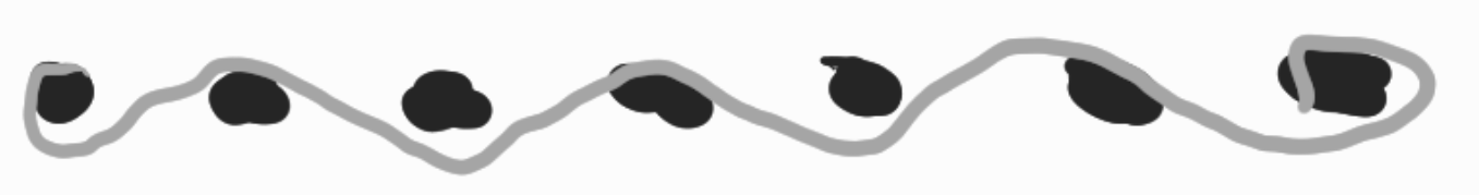

I'm working on a project where I'd like to have all pins on a female header shorted/soldered together. Problem is, I suck at soldering, badly. I tried soldering a piece of jumper wire across, and it came out really bad (even managed to melt one of the headers).

If you run the wire slalom style between the pins, it may be easier to solder. Keep the tip clean and tinned.

Oh okay. Looks like the soldering is melting properly and you don't seem to be using too much either. Looks like you just don't have enough hands so go with one of the pre-fastening methods for the wire others have mentioned. Don't use a clipped scrap lead from another component.
It also looks like you did it on it's side (laying loose?) That would make things tricky. Use a vice or holder. If you don't have one but you have a solderless breadboard, you can stick some male header pins into it and plug it upside down onto the breadboard so it stands on it's own.
