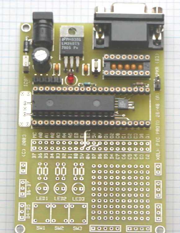

Yes, I've used their miniboard service several times now and the quality of the boards is great... It's about $20 per board, but, NO solder mask or silkscreen... Here's a picture of my very first PCB design...
Regards, Mike

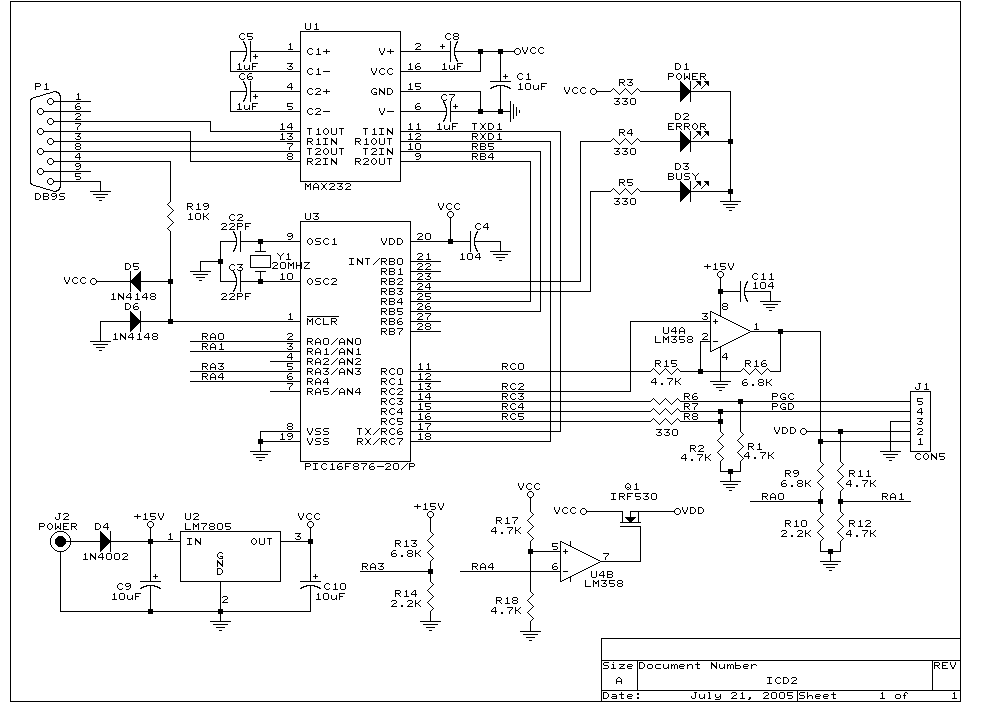

If you plan to make a new board, I'd recommend the newer version of the Lothar Stolz design with the LM358 chip. It uses fewer parts and easier to artwork.
I just built one initially using the older design with discrete transistors and then switched to the newer design. I found the newer design simpler to make and generates a more accurate MCLR VPP voltage.
Since I had a few IRF530 MOSFETs lying around, I added the VDD switching circuit using the spare half of the LM358.

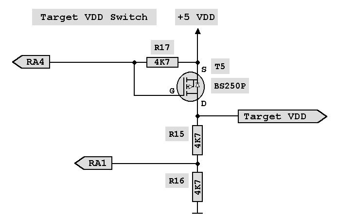

Yes, my home-made Serial ICD2 is using Lothar Stolz' design (transistor version) with minor modifications -- I installed a 78M08 regulator to provide the regulated 13 volt VPP voltage and I added a MOSFET high-side switch driven by RA4 to allow ICD2 control of Target VDD... There's a photo' of my home made ICD2 in message #157 of the Guestbook on Lothar's site...
Regards, Mike
