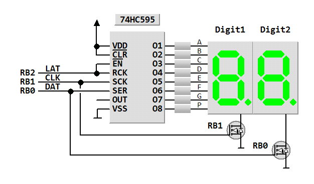

Do you know how to do it with 3 pins total using a 74HC595 and two transistors for his 2 digit display?

would it require 1 npn and 1 pnp?
No, I'll draw a sketch and attach it in a little while. It's really simple.
Here's the sketch...
brain-teaser-png.29729
When we're displaying digit 1 or digit 2 the RB2 pin is low which enables the '595 outputs and the RB0 and RB1 pins are setup to enable one of the column driver transistors.
When we're updating or refreshing the display we set the RB2 pin high which disables the '595 outputs and blanks the display. This also takes the RCK (latch) pin high so data clocked into the shift register goes immediately onto the output latches but this doesn't matter because the outputs are turned off so we won't see anything funny on our display. Now we retask our RB0 ad RB1 pins for use as SER (DAT) and SCK (CLK) lines to load the '595 shift register. While we're using RB0 and RB1 to load the shift register we're also inadvertently turning the column driver transistors on and off but this doesn't cause a problem because, again, the '595 segment driver outputs are off (the display is off).

There are a few subtleties to the code. It's important to leave the SCK (CLK) pin high after loading the shift register so that when we set RB0 and RB1 to enable the column drivers we'll never get a low-to-high transition on the SCK pin and clock in an unwanted bit. Also, we set the RCK and EN pins back to '0' to turn on the display in that very last instruction when we AND port B with 0xF8.

I think i get it lol
So you send data as normal when latch isnt on then latch it and set either the RB1 and RB0 depending on digit. then repeat by sending the appropriate data then latching?

Yes Jason, I think you've got it. Basically we use RB0 and RB1 as column driver lines during display "on" time and retask them for use as DAT and CLK signal lines during display "off" time to load the shift register.
One really neat thing about this method is that you can use a PWM signal on the RCK + EN pins for complete fade-to-black brightness control.
Regards, Mike
