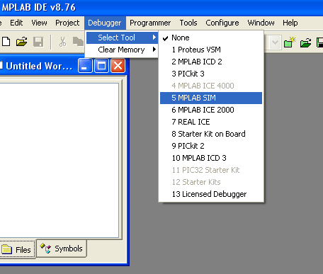

First start the debugger.
Choose MPSim

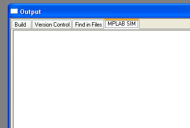

The output window gains a tab..

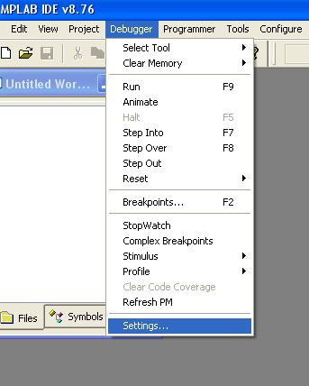

Then go back to the debugger menu and "Settings" is at the bottom.

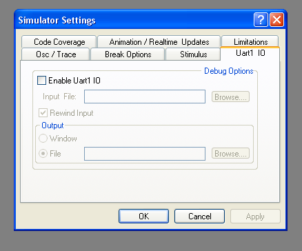

Finally open the UART I/O tab.
Now you can choose a register injection file to use for input ( The serial.txt file is in the zip file )
And choose output to window.
NOTICE** The stimulus file has "wait" parameters as the input is FAR too fast for serial polling...
