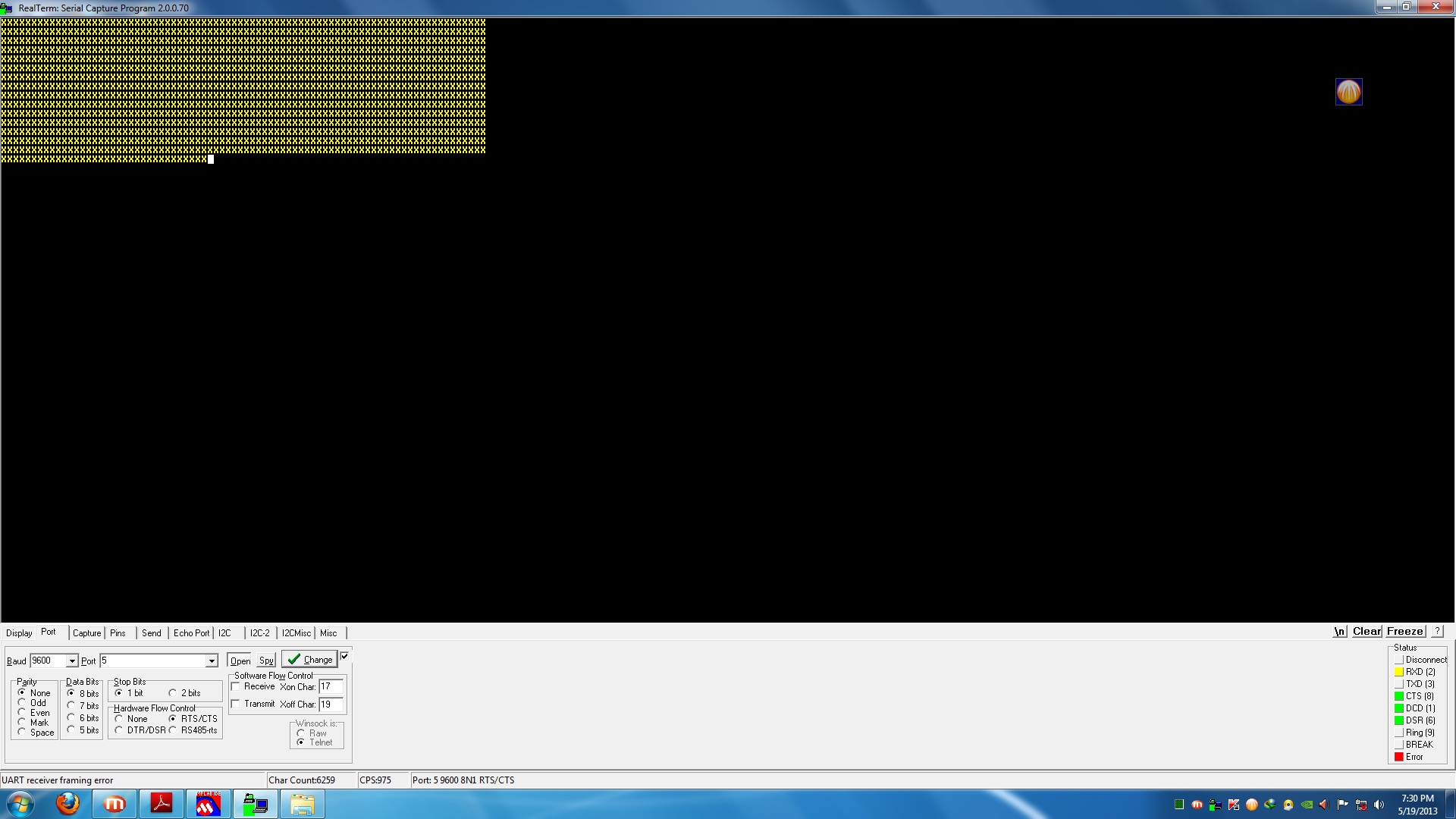

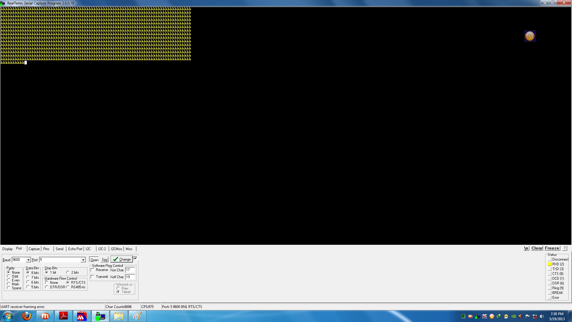

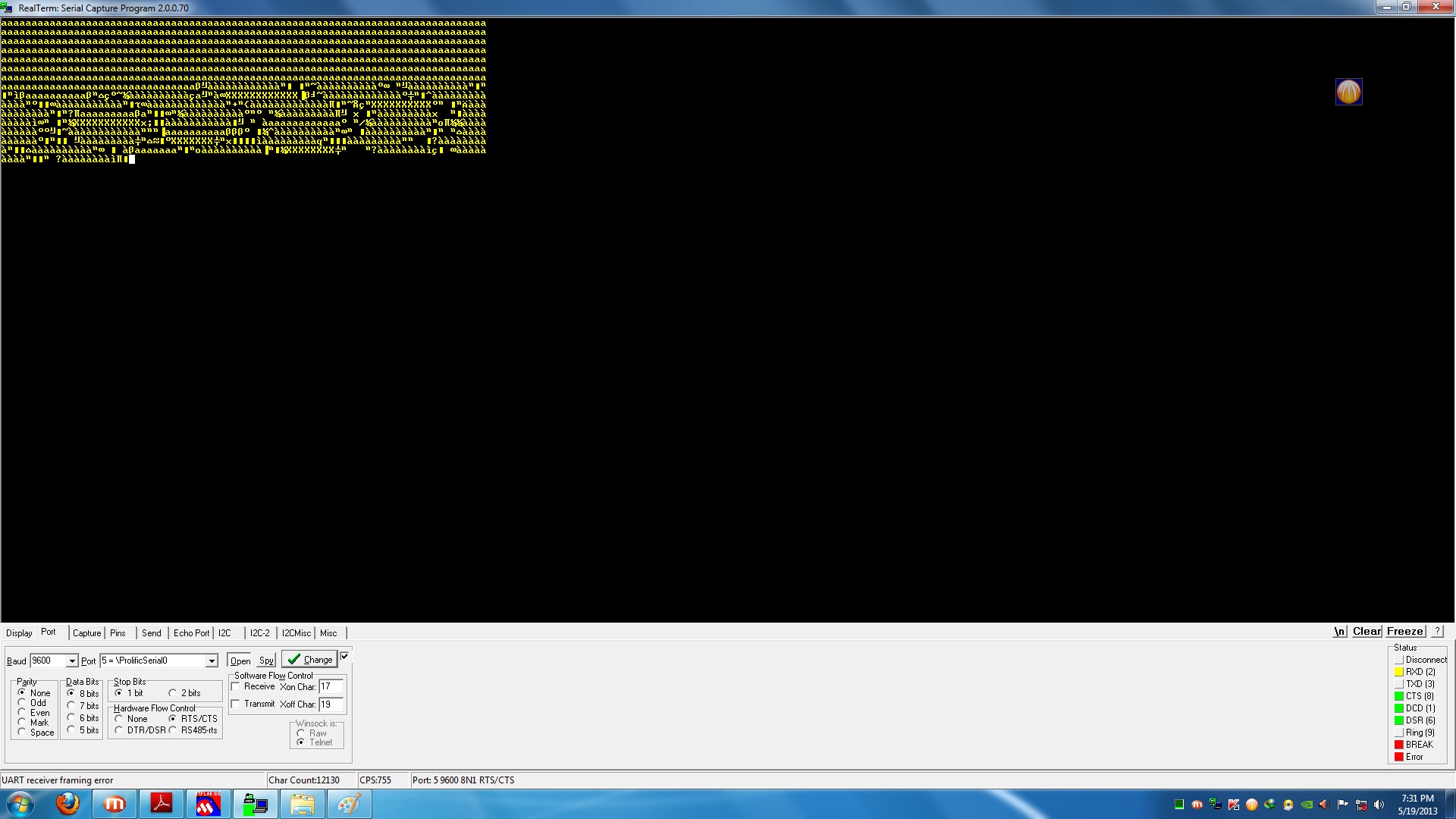

OK, it is working but few error are there i don't know them...
it is working now thanks...
but i found some problem it display 'a' also but some times other default character , why??
unsigned char  HSerin(void);
 void HSerout(unsigned char ch),
 HSerinit(void);
 void main(void)                        // program entry
   int index = 0;
   unsigned char ch = 'a';         // <- LOOK HERE.
   ADCON1 = 0x6;                    // Analogue off
   HSerinit();
  __delay_ms(150);
 while(1)                        // endless Loop
  {           HSerout(ch);                // Echo back
 void HSerinit()
   TRISC = 0b10000000;                    // should ideally be set
   SPBRG = 129;                    // 20Mhz xtal 9600 BAUD
   TXSTA = 0x24;                    // TXEN and BRGH
   RCSTA = 0x90;                    // SPEN and CREN
 void HSerout(unsigned char ch)     {
   while(!TXIF);                    // Wait for module to finish
  TXREG = ch;                        // ready to send
this work fine..
