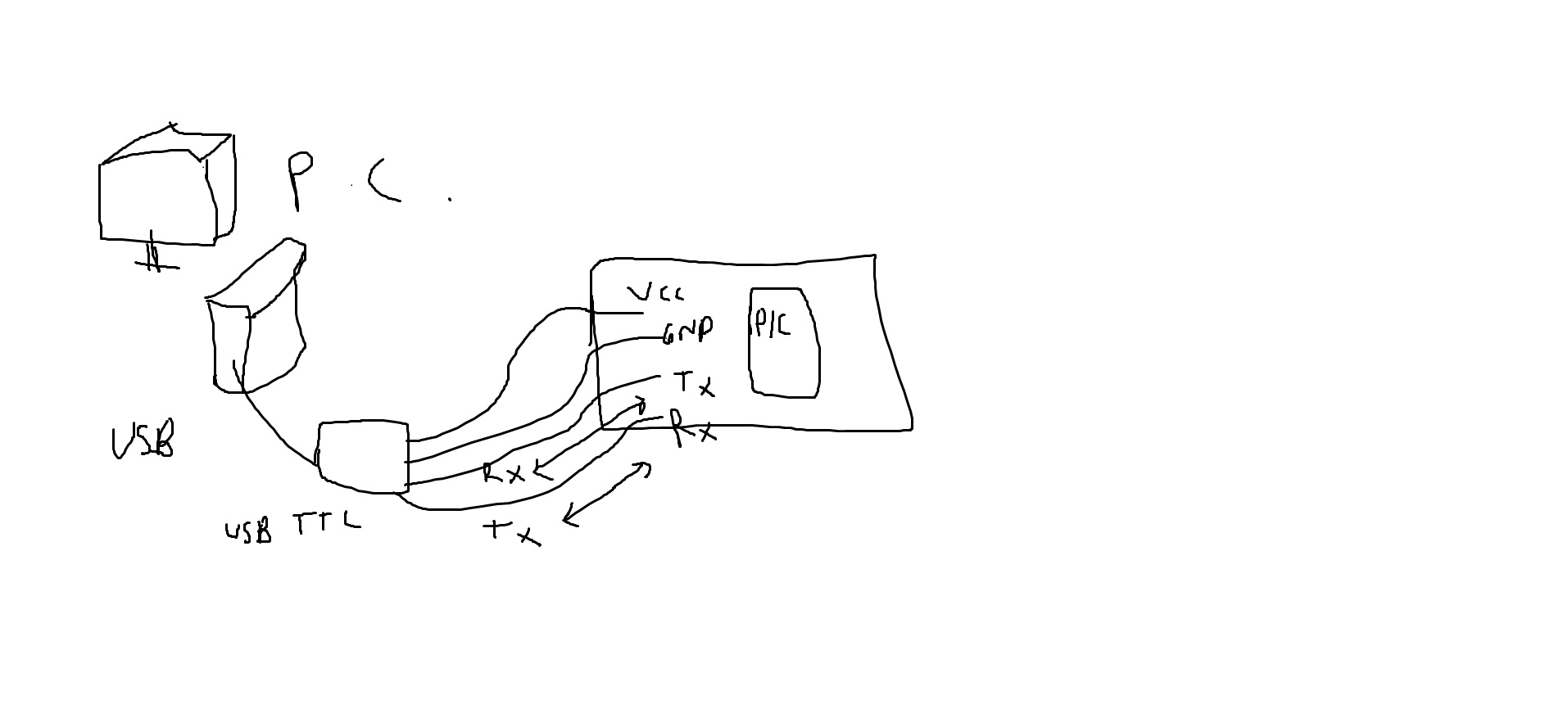

Serial comm between uC and PC...
OK, here is the schematic....

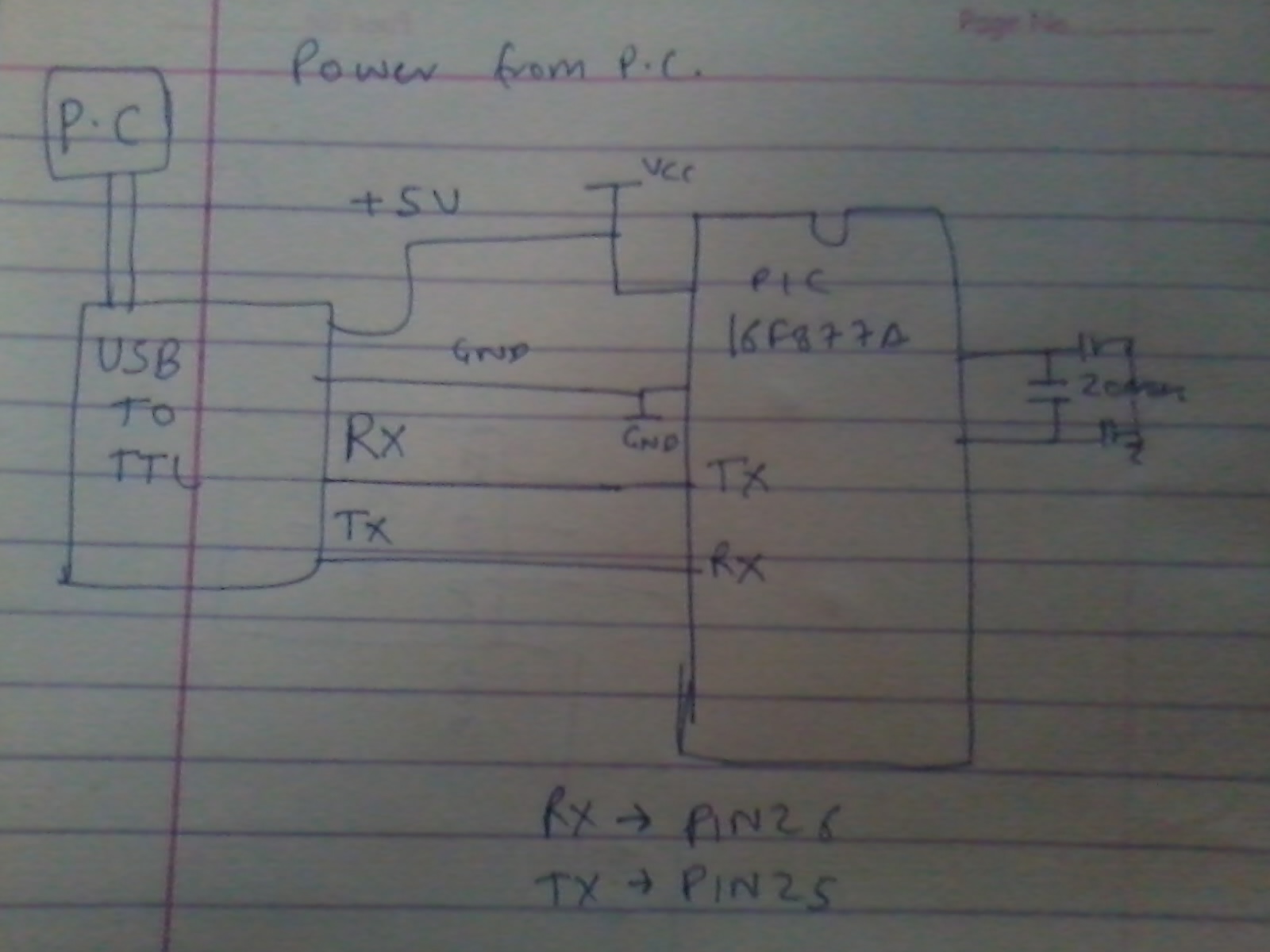

Is this fine now?? the power is taken from usb 5volt
Sorry Ritesh... I don't mean to take the mick, but as you can see the second schematic is MUCH easier on the eye..

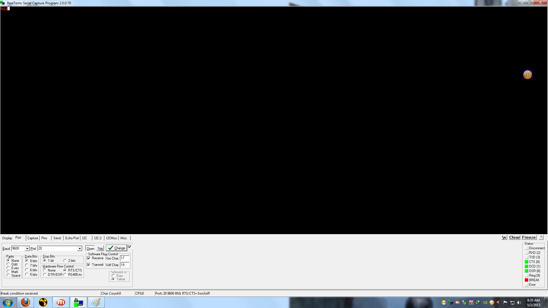

What USB to TTL have you got... FT232RL?... Also what are the characters in the terminal window... They are too small to see..
this one **broken link removed**
and i am writting random charater i have also installed Tera team for testing i am also sending data from uC to terminal window here is the code!

What output do you get from this little device.... Is it TTL? Or is it +10 -10 volt signals...
It is used to convert the serial to usb you can see the manual of it in link!
There is no datasheet or manual listed..
This is described as a Virtual Serial port, suggesting that the output is RS232 levels , not TTL... If this is the case it will damage your pic.
Have you got a scope to measure the output voltages???
I am using 5V from USB only the chip used by it is **broken link removed**

I'm pretty sure that module has a TTL output level suitable for direct connection to 5v microcontroller pins.
One simple test is to send a 0x00 byte manually out the PIC TX pin at 1200 baud, then set the terminal program in the PC to 1200 baud and see if it is received ok.
That can check your wiring and does not depend on any USART stuff.

It is working on 5V from USB i think TTL
You could sometimes try to read the datasheet specs yourself. That way you would not have to guess.
The datasheet says:
RS232 pins RXD_I, RI_I, DSR_I, DCD_I, CTS_I are 5V TTL Schmitt Trigger inputs.
RS232 pins TXD, DTR_N, RTS_N are 3.3V tri-state outputs.
