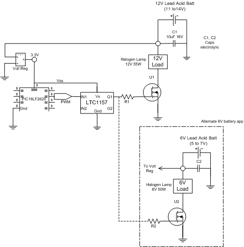

Looking for some help selecting MOSFETs and R/C values for a PIC lamp control circuit. I'm trying to use a PIC18LF2620 PWM output to drive a Halogen lamp using a lead acid battery for power. The PWM freq I'm guessing to be around 1K Hz, but not sure. It's for a night predator hunting app, and don't want any flicker that coyote eyes can see.
I need to use 3.3V because of the RF tranceiver I selected. I'm not an EE guy and have very limited electronics knowledge let alone MOSFETs, and I'm drownding in all the choices. I think I need a logic level MOSFET (for 3.3V Vss) that can handle maybe up to 20V and 10A (for possible lamp upgrades). I planned to include the MOSFET driver shown in attached circuit. But that's as far as I can figure out. Help would be appreciated!!:eek: (You can get a PIC kit pretty easy, but I guess it's the hookup to the real world that'll get ya.)
I have two configurations I want to build, one with a 12V battery powering a 12V 55W Halogen, and the other a 6V battery with 6V 52W Halogen. If I can use the same MOSFET for either that would be great, and if I use a MOSFET that can handle even greater power output, that would leave me room to control bigger and better lamps down the road I guess. :D
I'm a software guy by trade, but can read schematics a little which gets me into trouble (like with this project :), so please bear with my lack of knowledge.
Thanks!
1.) Do not use a high side driver like the LTC1157! If anything use a low side driver.
2.) If you keep the PIC at 3 volts use 5 volts supply (or higher) on the FET driver. It is a little hard to find FETs that like 3 volts.
3.) If your PWM is only 1khz then you may not need a FET driver.
24N06L, IRF6607, IRF6618TR
The LTC1157 has an internal boost converter which will supply 8.7V to the MOSFET gate in your design. Therefore you don't need to worry about getting a 3.3v MOSFET.
However, the LTC1157 has a very low gate drive current resulting in a slow turn on speed of the MOSFET. This will increase the power dissipation of the MOSFET (it will heat up more than it needs to).

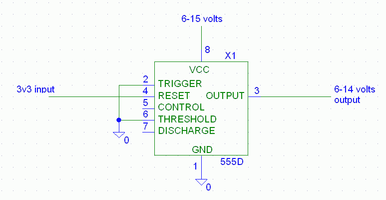

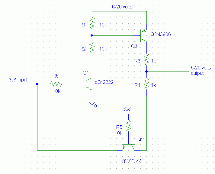

You could also drive the gate from the high voltage (6-12V) supply, as many MOSFETs can handle up to 20v on the gate. You could use something like the attached circuit, or you could get a different driver chip that does this for you. In fact, you can use a LM555 to drive the MOSFET (see 2nd attachment) so long as the supply voltage doesn't exceed 16V.
Dougy83 is correct. The LTC1157 does boost up the gate voltage. I only had a sort description of the part that only said “high side driver” and did not mention “boost up”.
