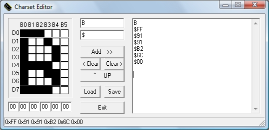

This simple character set editor from from geocities.com/g13685/DMX_973_973B.html creates the data arrays for each character in the format I outlined in post 17. Data is by column, starting from the top. A constant array should be created for every character to be used.
Next, dimension a data array with enough bytes to hold all the characters of your message and add the character data to this array. This is the last time you use the constant data.
Now, display the first 8 bytes of the data array, continuously multiplexing the first 8 bytes. After the first 8 bytes have been displayed for the desired time, increment one byte in the array and display 8 bytes for the desired time. Increment. Display. Wait. Repeat.
THANKS that will aid in generating the CONST arrays.

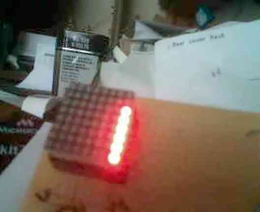

I took a revisit to my code in post #29 https://www.electro-tech-online.com...on-an-8-x-8-matrix.139965/page-2#post-1169064 and after turning the letter right side up and scrolling from right to left . Looking at this code it basically does what you in post 22 https://www.electro-tech-online.com...on-an-8-x-8-matrix.139965/page-2#post-1168843. Slowed the scrolling down and it looks pretty good.
Problem now is changing the variable names.
Using a sub route I am needing to rename the different CONST array names but keep getting compiler errors.
SUB a1_data()
  FOR index = 0 TO bound(anodes_data)
     Anodes_data(index)= A_Data(index)
  NEXT     '0
END SUB
The sub route is a1_data. Need to change Anodes_data(x) to A_Data(x)
Had the Anodes_data(8) in a CONST array but realized the CONST array data can't be changed so I took out the CONST array Anodes_data so hopefully I can just rename Anodes_data(x) to what ever CONST array name I want to call it.
Why do I get the feeling that no amount of explanation or elaboration will make you understand this? I think four times is my limit.
You're on your own.
Well I got the multiplexing as in your suggestion post 22 https://www.electro-tech-online.com...on-an-8-x-8-matrix.139965/page-2#post-1168843
Now to figure out how to get it to scroll.
I have code that scrolls but really no multiplexing to conserve battery power.
In this posted code I have a short version and a long version that shows what the short version is doing. This is what I interrupt your suggestion in post #22

MrDEB, why don't you look at post 24...it references a tutorial on multiplexing a four digit LED display. Yes, I realize you want to multiplex an 8x8 matrix, but prehaps multiplexing an 8x8 matrix is similar to multiplexing a four digit LED display. Maybe you'll find the multiplexing a four digit LED display is similar to multiplexing an 8x8 matrix. *shrug* maybe multiplexing isn't the same as multiplexing but maybe you could learn something about multiplexing.
Now, saying your code is EXACTLY what I've been suggesting is a little hard to fathom. I have suggested a number of times the you built the font (i.e., the characters) as constant arrays (and even posted a link to a tool to help you do that) AND THEN build the message characters into a VARIABLE ARRAY containing the entire message. Since your code doesn't even dimension a character array, I don't have to struggle with trying to understand what the hell you are doing to know it has nothing to do with what I suggested.
Time for you to throw in the towel on this one I should think.
I like the idea of using a variable array then use the CONST arrays to fill in the variable array information.
Going to take a break and revisit post 16 and 18 as well as post 24. I started revamping the 7seg ,bas to fit the 18F2420 and get a better idea of where I went wrong on the multiplexing.
I was pretty sure this did the multiplexing but ?

I have tried lots of different methods to try and acomplish this.
Revisited your post about how this is done by scanning the cathodes or anodes etc. I tried both.
I tried loading one byte from the CONST arrays then cycle through the 8 bits then jump to the next byte. didn't work.
Looks like my clunky code I posted is what I am stuck with. At least it works.
In the quest to make the great code to show a word on a 8x8 led board. You have 16 pins you turn on one of each to flash a led then the next led till you made a letter show up want it to move easy you shift the rows
I tried that Burt but I lose the trailing edge of the letters. I tried several bits of code.
Let me get back to you, my wife is needing my assistance and be back in a few minutes.
First off you get one letter to light up like you want it say O you get it to show up clearly made sure your code blanks the port on the shift and then just shift it off to the right or the left it's that easy
Here is my latest code I have been trying but It is no way close.

Have seen really long CONST array LONGWORDS.
Going to research this after I redo the alphabet to 5 bits wide per letter instead of 8 bits wide.
5 don't add up to 8/8 I don't see that saving anything lol but maybe it's something I don't see but the pic is 8 bits so you'd waste 3 bits
You have to set two ports so I'd figure it as a word add load both ports at time till you see a nice letter then shiff the rows
He is saying make the letter 5 bits wide it's still a byte
Good point, the extra three bits are wasted but Still contemplating how to get tis scrolling from a better code. The code I posted works pretty well seeing how I wrote it but in the interest of learning to write better code I want to streamline it.
You referred to shifting the two bytes, are you suggesting using the shift.bas?. I was under the impression that's for shift registers??

Here is a short video of what I have so far using the code I posted. The letters need lots of work as does the smoothing out of the scrolling.
Am looking over lots of other codes but most are using shift registers or just duplicating each byte but shifting one bit to do so the scroll. This would entail 64 bytes per port or 512 bytes per letter.
I would recommend watching that frame by frame ;), stick it into some video editing software. It will show you whats wrong
