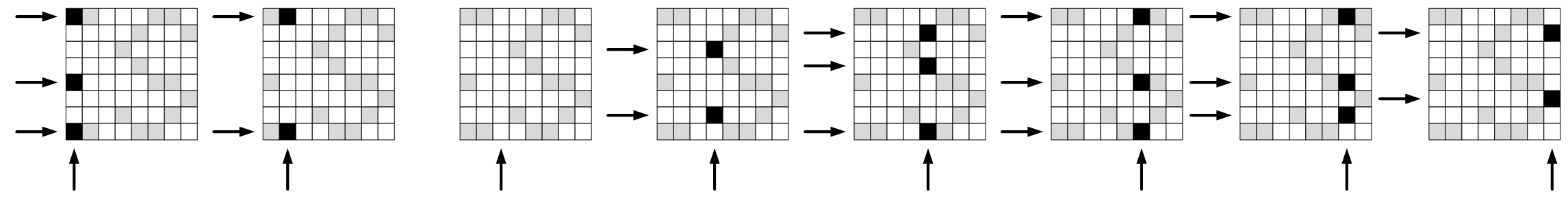

There is one byte per column. The data is correct as shown - figure out why.
The single array provides all the required information to control the matrix. Why complicate it with two arrays?
This is the approach I would take and I think it's well explained. You of course are free to do what you like. If I need to clarify anything in this approach, I will try to do so.
I think you're confused (imagine that?). To use an 8x8 matrix LED array, you have to multiplex the data. This is quite apart from scrolling.
The illustration below may help. It shows the window of the message from the above illustration. You need to do the following just to display the data.
1. Set the 8 data bits for column 1.
2. Turn on column 1.
3. Turn off column 1.
4. Set the 8 data bits for column 2.
5. Turn on column 2.
6. Turn off column 2.
7. Set the 8 data bits for column 3.
8. Turn on column 3.
9. Turn off column 3.
....and so on.
You must refresh the entire display more than 24 times a second to prevent flickering. This sequence must repeat continuously whenever the display is showing something. Thus, two arrays make no sense what so ever.
The scrolling happens at a much slower rate. It involves relatively slowly cycling through the data array.

I am going to start looking over what I have and figure out why Jon has bytes missing in post #18

I started basically from scratch, verifying my port bits and after writing this short code I realized I was trying to turn on the anodes from C0 to C7 in a FOR X = 0 to 7 loop portc = Anodes_Data(x) instead of just reading Anodes_Data(0).
the code here scrolls a solid line from bottom to top of matrix.
Now I understand why Jon had the bytes in post #18 except the missing bytes??
.... and figure out why Jon has bytes missing in post #18...
The data accurately reflects what's shown in the illustration.
Thanks Ian. This one, I'm making up as I go. Personally, I'd use a chip like the AS1106 to do this and relieve the micro from the busy work of refreshing the display.
Well making some progress. Figured out the missing bytes in Jons post and finally got a letter K to scroll across the display. Not perfect but it works. needs some work, lots of it.
Plan to get this letter K working then assign each letter as a variable in portc then just cycle through this one routine. I realize this is not done but doing lots of different things and making it work. After I see where I made my mistake, thanks to Jon, about the data numeration in the CONST arrays allowed me to see the forest dispite the trees.

CONST Anodes_Data(8)AS BYTE =(%11111111,
                               %00011000,
                               %00100100,
                               %01000010,
                               %10000000,
                               %00000000,
                               %00000000,
                               %00000000)
CONST Cathodes_Data(8)AS BYTE =(%11111110,
                                 %11111101,
                                 %11111011,
                                 %11110111,
                                 %11101111,
                                 %11011111,
                                 %10111111,
                                 %01111111)

y = 0
// Main Loop
WHILE True()
       portc = Anodes_Data(0)     '0
       portb = Cathodes_Data(0)
       delayms(1)
       portc = Anodes_Data(1)      '0
       portb = Cathodes_Data(1)
       delayms(1)
       portc = Anodes_Data(2)      '0
       portb = Cathodes_Data(2)
       delayms(1)
       portc = Anodes_Data(3)      '0
       portb = Cathodes_Data(3)
       delayms(1)
       portc = Anodes_Data(4)        '0
       portb = Cathodes_Data(4)
       delayms(300)
       'xxxxxxxxxxxxxxxxxxxxxxxxxxxxxxxxx
        portc = %00000000
       delayms(1)
       delayms(1)
       delayms(1)
       delayms(1)
       portb = Cathodes_Data(5)
       delayms(300)
       'xxxxxxxxxxxxxxxxxxxxxxxxxxxxxxxxxx
        portc = %00000000
       delayms(1)
       delayms(1)
       delayms(1)
       delayms(1)
       portb = Cathodes_Data(6)
       delayms(300)
        portc = %00000000
       delayms(1)
       delayms(1)
       delayms(1)
       delayms(1)
       portb = Cathodes_Data(7)
       delayms(300)
       'xxxxxxxxxxxxxxxxxxxxxxxxxxxxxxxxxxxxx
         portc = %00000000
       delayms(1)
       delayms(1)
       delayms(1)
       delayms(300)
       portc = %00000000
WEND                  // Loop back to the while loop as long as we havent finished.

I understand post 17 and 18 regardless of the error in the space between the A and the G.
I got single letters but getting them to scroll across is the issue.
I got the K to scroll using my posted code but I want the K to scroll from right to left
Will try the scanning of the variable arrays as suggested.
Johns explanation in post 17, 18, and 22 will only show one letter at a time but not scrolling across. Here is my interperation of what needs to happen when scrolling
WHILE True()
FOR x = 0 TO 8
FOR y = 0 TO 7
PORTC = Anodes_Data(y)
portb = Cathodes_Data(x)
DELAYMS(50)
NEXT
NEXT
WEND
WHEN USING ABOVE LOOP IT ONLY DISPLAY ONE ROW AND CYCLES FROM RIGHT TO LEFT
WHEN SCROLLIN FROM RIGHT TO LEFT YOU NEED TO ENABLE
  1. ROW 0/COLUM 0
  2. ROW 0/ COLUM 0 AND ROW 1 COLUM 1
  3. ROW 0 COLUM 0, ROW 1 COLUM 1 AND ROW 2 COLUM 2
  4. ROW 0 COLUM 0, ROW 1 COLUM 1, ROW 2 COLUM 2 , ROW 3 COLUM 3 AND ROW 4 COLUM 4
    ETC UNTIL ROW 7 OF THE ANODES IS ON COLUM 7 UNLESS YOU HAVE SPACES

DATA NEEDS TO BE DISPLAYED AS THE CATHODES PROGRESS FROM 0 TO 7
Am sure tumbleweed can figure it out. He seems to figure out these train wrecks.
I tried the message with different loops and the loop needs to recycle the privious dadt as it progresses on the display.
harder than it looks
Post #17 outlines exactly the procedure needed to scroll text data across one or several 8x8 character arrays. Going from this description to code is straight forward to anyone who is not a copy&paste wannabe programmer.
