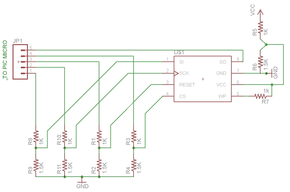

OK i should have my pics in about 2-3 days. While i wait. I wanted to know if this looked ok. I made it for a 16mbit chip i have its the AT45DB161D (ATMEL) its SPI and i wanted to know if i should be good if i connect it like this with voltage dividers. Would this work? The TO PIC MICRO header is there to signify connections to a pic like SDO, SDI, SCK and other pins that may be used from pic to chip and chip to pic.
U1 is the SD card? SI is CMD and SO is DAT0?
What is RESET then? Should be no such line required to the SD.
SD needs 3.3V, GND, CD (CS - chip select), CMD (data in), DAT0 (data out), and CLK (clock). The card-detect and write-protect lines are optional.
Pullups (to the 3.3V VDD) are required on all data & clock lines to the SD (and write-protect/card-detect as well, I think).
I assume you've done the math for those voltage divider resistors? I'm too lazy to check.
Aren't the level shifting resistors rather low values?, seems a waste of current for no reason?.

I wanted to know if a connection like that is possible? Im not sure you can tell but they are pulled up.
when you send a 0 then the line is 0 since 0v & GND doesnt make a voltage. When its a 1 the line is 3.x volts. Since 5v and 2 resistors(voltage dividers) to gnd = a high voltage.
how about R1= 33k & R2= 17k
That should be a exact 3.3 Volts @ about 100ma
OR
R1 = 12K
R2 = 6K
Would make 3.3 Volts @ 277ma
I have on hand many resistors but none exact. Like i have a 12k & 5.6K which would make it 3.40 Volts @ 284ma

ok so now i ask again lol does this seem like it would work? like if i connect it like that schem i should not have a hardware or wiring issue right?
ok please read the following quote
"DO NOT WORRY ABOUT RESISTOR VALUES THIS IS JUST A EXAMPLE OF LAYOUT"
ok with that said how does this look? I know the divider resistor values to use 12k & 5.6k what should the pullup resistor values be?
Also how does it look overall so far? notice-able issues?

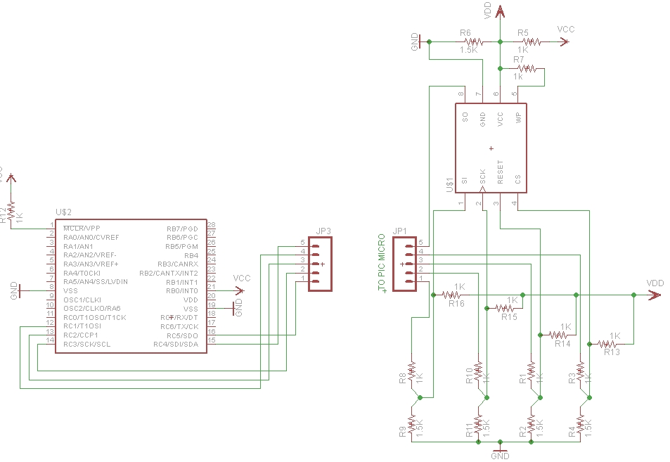

EDIT: NOTE:
NOTICED a error in vcc pullups need to be to the vcc of the main divider.

Why not run the pic at 3.3V too and throw out the level shifting. 5V PICs run on 3.3V , but it cant work at its max clock rate (There is a graph of max clock vs supply voltage in the datasheet), but mostly half the max speed is fine.
Or you might also consider getting one or two of the dsPIC33F, They run off 3.3V and run up to 160Mhz from that.That might be useful if you are doing some more advanced projects with it and need some extra processing power.
i dont want to have to always run away from a issue. At the moment i have 5v pics only and would like to use then. This is something need to learn anyway. Especially if i cant avoid it in the future.
Yeah i know. I had to do level shifting too cause i used a 5V PIC and i wanted to run it at full speed. At first i just used half the speed and ran it all at 3.3V just to firstly get the card working.
These days its mostly best to run more complicated projects on 3.3V since almost all modern ICs work from 1,8V to 3.3V. This is mainly because ICs use less power at 3.3V also means lower voltage baterys (or getting rid of DC-DCs) Also 3.3V pics have 5V compatible I/O, its a very useful feature if you end up with a IC or two in your design that cant work on 3.3V

ok im using a LF4620 now and i can even read sector 0. The same data on sector 0 is what i can dump when i connect card to pc and manually check it.
