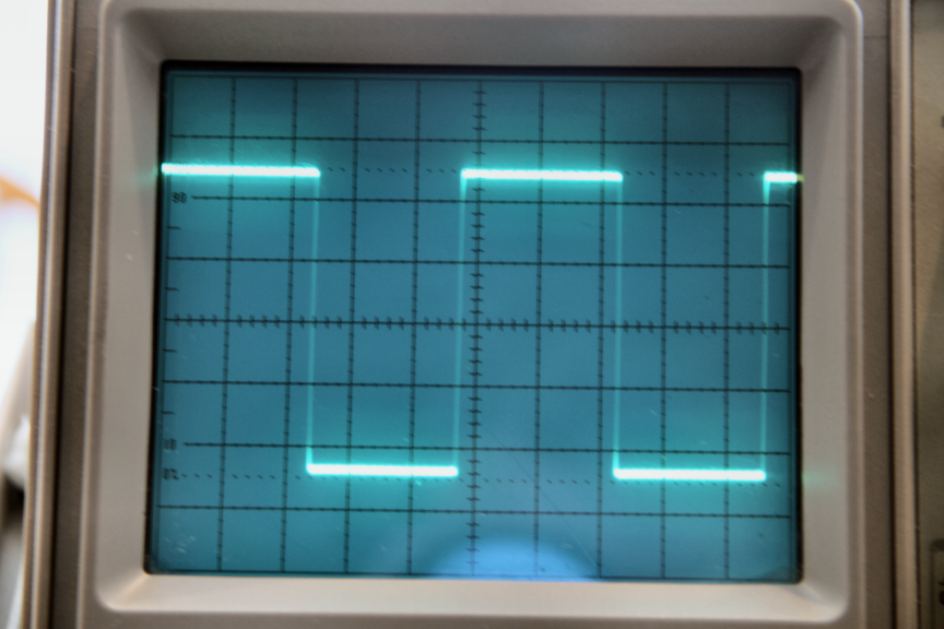

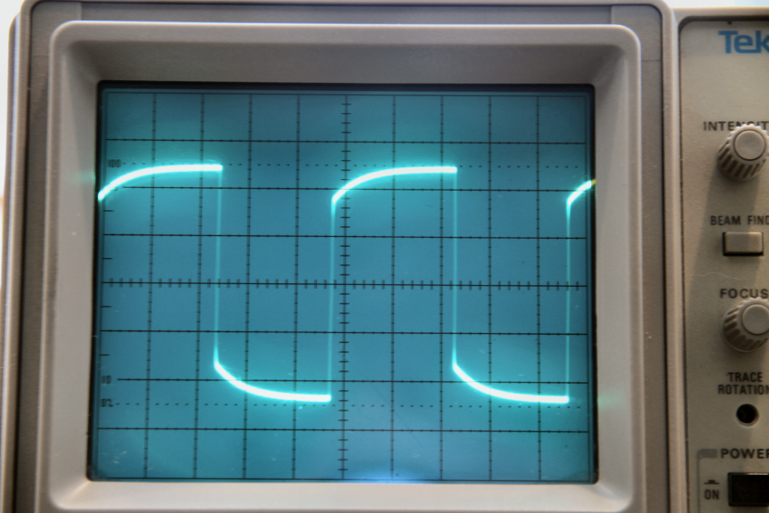

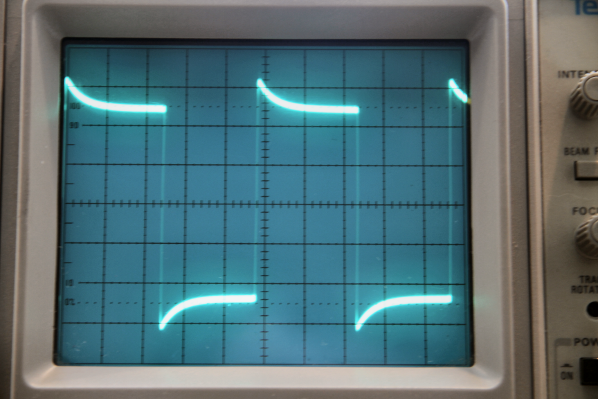

CLH333, what you are seeing is likely normal as was mentioned. You won't easily see the vertical transitions. For example here is a cal square wave, for these pictures the scope intensity was really turned up to the point the tops and bottoms are "blooming" just to see the vertical transitions:
Keep in mind also that Cal Out signal is merely a reference signal. It is not a highly accurate signal to calibrate the scopes vertical or horizontal gain. If I were to reduce the intensity the vertical transitions would no longer be visible.
Ron
