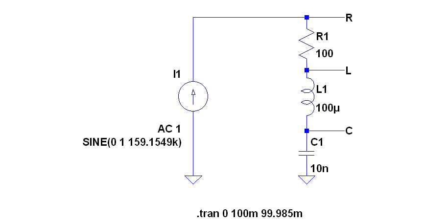

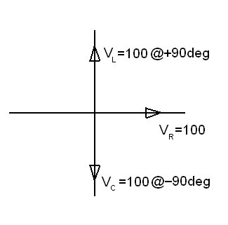

I admire your determination to further your education, and I'm going to post a vector diagram of your circuit, with an explanation. Hopefully, you will understand it.

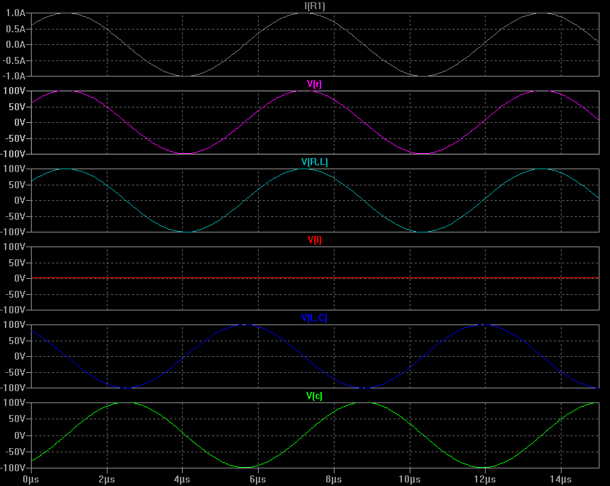

Look at the waveforms below. You can see that the voltage across the capacitor V(c) is 180 deg out of phase with the voltage across the inductor V(L,C), so they cancel. Note that the voltage at V(L) is zero (LTspice won't let me make the "L" a capital letter), because of the cancellation. Since the voltage across the resistor V(R,L) is 100V, the source voltage is also 100V, which is your answer.
I chose a current source as the source, but you could just as easily make it a 100V source, and all voltages would be the same.
EDIT: In the vector diagram, VL and VC cancel.
