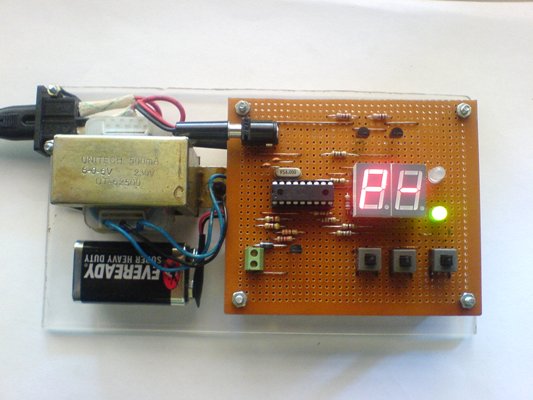

*Display check – to check the two segments working correctly when power up.

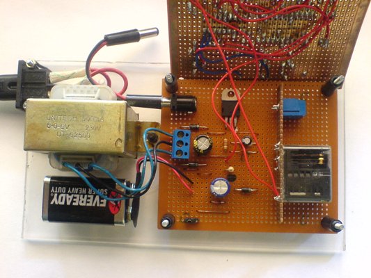

*Battery backup

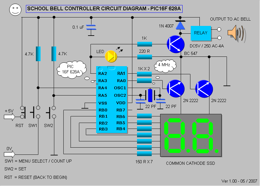

hi gayan,
Looks good to me.
What's the PP3 battery for??
Do you have a box/enclosure for the pcb/display assembly?
Are those little white clouds on the circuit diagram , puffs of smoke?? :rolleyes:

Use a 32768 hz watch crystal instead of the 4mhz crystal.
The wee 32khz will not only run at much lower power than 4mhz its also more accurate and easier to divide into seconds (use timer 0 and 1:32 prescaler for an exact 1 second overflow)
I like the circuit diagram.. Looks very cool. What did you use to make it?

This battery for the backup power supply if the AC power turns OFF.
Also there is a small DIP switch in the layer2 board to turn ON/OFF the battery back up.
9V battery can supply the circuit for 8 HRS until school over. I have dropped down its voltage to 5.1V.After last bell circuit enters to the SLEEP mode.
If no AC power the AC Bell also not working. But the circuit is running until the power comes. For sudden AC mains fall offs or the delay when shifting to the generator this battery very useful.
For the time being I don’t have an enclosure. I’m planning to build one. Just now I found a plastic sheet shop.
Puffs of smoke are call outs :D

The low power crystal is good, but due to unavailability of that 32 KHz I shifted to standard 4 MHz.
Otherwise I have to sacrifice a working wrist watch for this project :rolleyes:
In overall, considering power, spacing, coding, accuracy the watch crystal is ideal.
Too bad the 32KHz crystal is a hard to get where you are. They are very delicate and might be a trick to desolder.
TMR1 can use the 32KHz and your PIC could run from internal RC , you can even put it to sleep and TMR1 will wake it up when it overflows (2seconds or multiples of 2sec)
