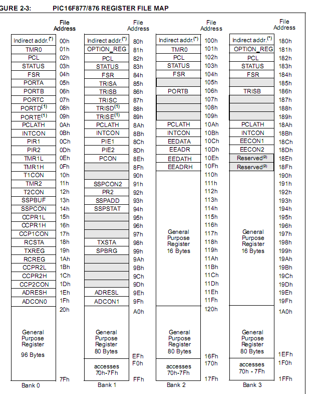

Hi Suraj,
Sorry I clipped the 16F876 register image by mistake.!!
Have you used ALL the free registers in Banks 0 and 1 .??

Hello PIC16F873A is not like other PICs.
There is no common bank area between Bank0 & Bank1.So the above code will not work.
That's why I'm still struggling how to save W register.
The last 16 bytes of all 4 banks access the same (common) area. See page 17 of the data sheet.
Mike its in Page 18.Not in Page 17.
Bank0 & Bank1 is not shared in PIC16F873A.
@Suraj
Mosiac gave the correct idea by saving W in a SFR which is not used.Other wise you have to switch to another PIC like PIC16F886 which has the same pin count.
I never realised that the 873 didn't have any common area and presumed the family all had the same common area. However, the problem is easily solved, define W_TEMP at the same offset in both banks (call it W_TEMP1 in bank 1). For example at 0x20 and 0xA0. Then use the context save from the data sheet.

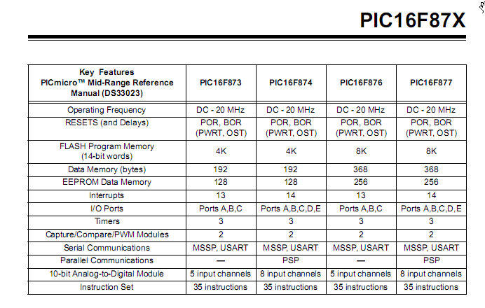

hi Suraj,
I would advise you upgrade from a 16F873 to a pin compatible 16F876, this would solve your GPR problems.

Ok guys I planned to shift to another PIC that's the only solution because registers like FSR & INTCON I use both in main & in the ISR.So I cannot use a SFR in this design.
If you are going to a better chip then may I suggest the newer 16F886 as that has an internal clock.
