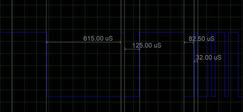

I am writing OneWire communication between STM32 and DS18B20. There should be applied precise delays in us, as I know, HAL guarantee only ms, so at this play timers came into play.
When I started an application, I saw that values on the oscilloscope not fully matched expected delays.
Is there anyway to ckeck if my delays in us countinng properly? I am using 8 MHz BluePill with 8-1 Prescaler.

My last results is that I use this code, where delay_us is function for microseconds:

615 us is reset pulse and 125 presence. This timing across the normal range as I expect:
But when we talk about writing bits, I got minimum 32us where I plan to have a <= 15us:
Up to now I didn't find any way to set it properly... I told with some DIY guys, they said that there is no way to expect from Proteus this accuracy :D
