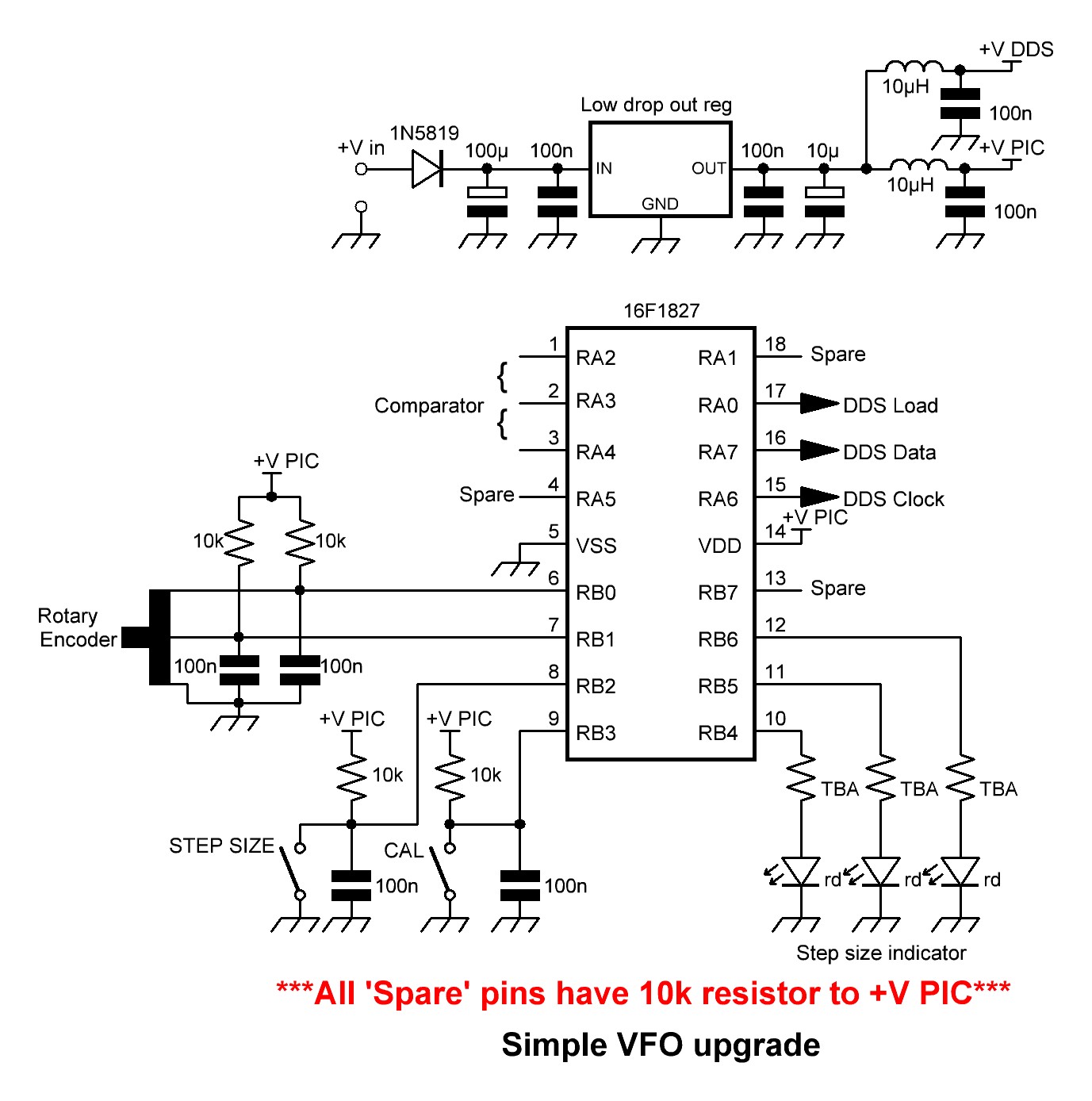

Do you have a schematic you can post.....?

No switch involved, just a voltage divider off the unregulated rail to detect a power off condition - this is fed in to PORTB,7 pin set up for interrupt on falling edge trigger.
Divider is 4k7 & 2k2 from power rail with the tap off to the PIC.
The power off condition is as in somebody shut it down, not a random power fail circumstance.

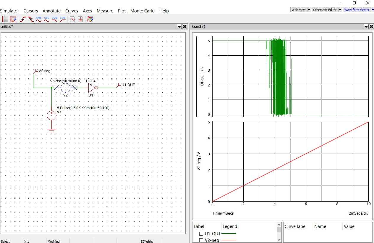

If power fail ramp rate very slow it will produce, due to noise on Vcc and on power divider
from supply, a possible condition where input looks like a bouncing switch.
Example sim of CMOS inverter, 5V ramp, and 100 mV RMS noise at input of gate. As
you can see output of gate, as ramp passes thru its threshold, oscillates significantly
due to small amount of noise and G thru gate.
A Schmidt at input of processor, or use its A/D for V detection, or debounce it in code.
Regards,. Dana.
Yep, got the scope out and seeing something similar in 'real life' about 50ish % of the time.

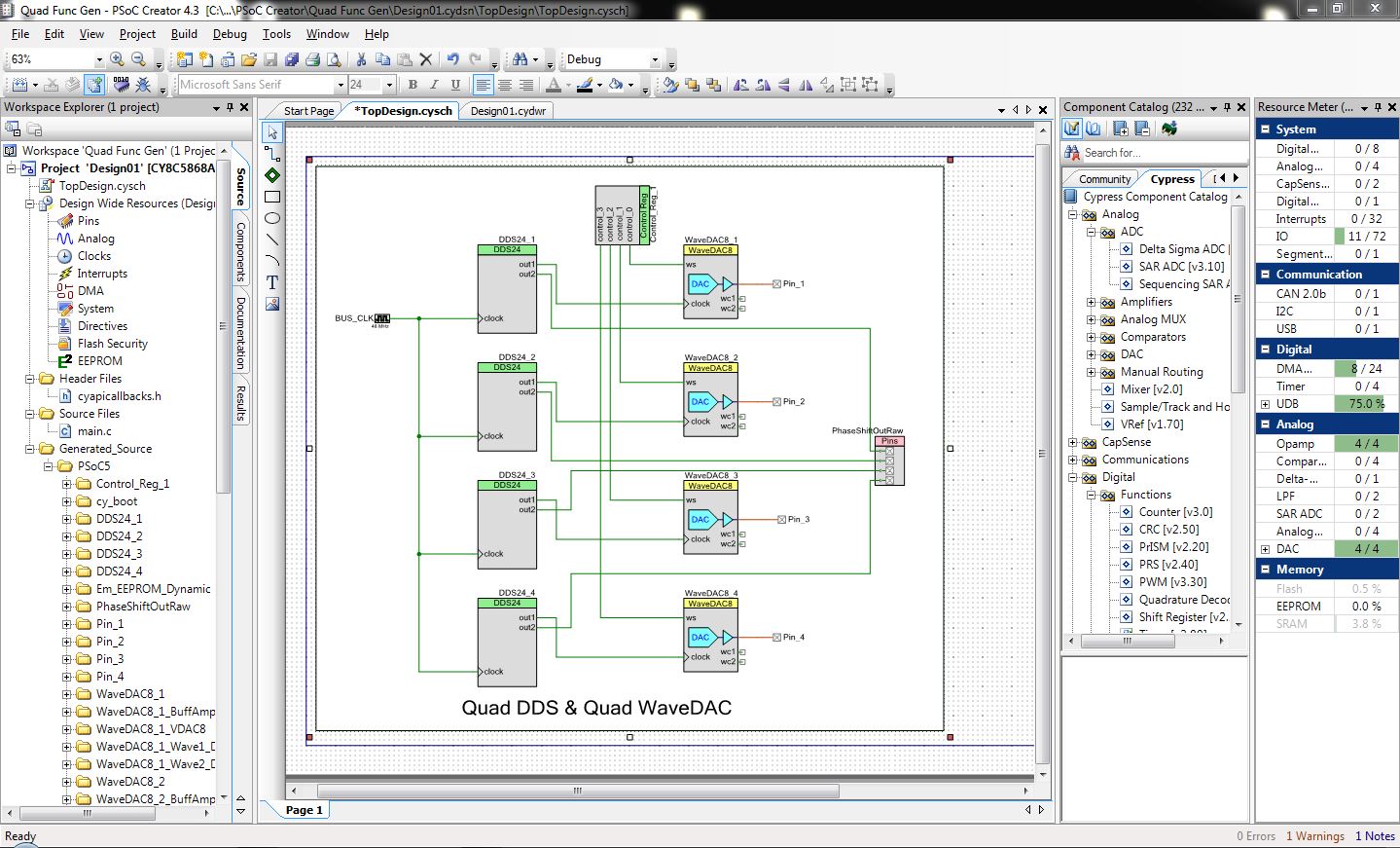

What is range of freqs out of the DDS needed ?
There are ARM processors out there with DDS on chip....example of a single chip solution that
used 2 DDS, all onchip -
1621444400166-png.131480
Another approach with same chip, quad wavedac generator -
quad-dds-and-wavedac-jpg.159414
Regards, Dana.

Here's the code, I stripped everything else out to play with the comparator.
C-like:
;                    comparator-16F1827.asm
; Target Controller        PIC16F1827
;                __________
;        COMP-PLUS--RA2 |1       18| RA1---SPARE
;        COMP-NEG---RA3 |2       17| RA0---DDS_LOAD
;        COMP-OUT---RA4 |3       16| RA7---DDS_DATA
;        SPARE------RA5 |4       15| RA6---DDS_CLK
;        Ground-----Vss |5       14| VDD---+5 V
;        ENCODER----RB0 |6       13| RB7---SPARE
;        ENCODER----RB1 |7       12| RB6---LED STEP 10kHz
;        STEP SW----RB2 |8       11| RB5---LED STEP 1kHz
;        CAL SW-----RB3 |9       10| RB4---LED STEP 10Hz
