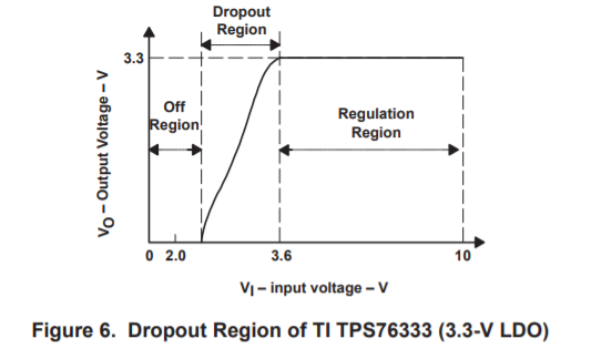

I happened to be looking at the electrical characteristics of another pic and noticed the EEPROM erase/write cycle time - typically 4mS - maximum 5mS per byte. The flash write cycle time for a row of 32 locations (14 bits each) is maximum 2.5mS. It might be worth further investigation.
This thread got me thinking about calculating Vdd from the ADC reading. On the newer chip (your included) you can use Vdd as the ADC reference and feed the ADC the fixed voltage reference. This gives a reading that increases as Vdd decreases as the 2.048V stays the same.
I played around with some code. It generates a 100uS interrupt and starts the ADC on each interrupt, on completion of the ADC reading it places the value in a variable (called value). It's in C but the general idea will work in any language. It's written for a 16F18854 as I happen to have some boards laying around with those on. Some of the registers are different to the 1827.

If using a LDO many, when they go into saturation, become a fixed V drop
relationship to their input voltage. To a point.
Its more involved to do the design by measuring Vout of reg but has the advantage that
what you are concerned with is Vout of the regulator. Note some datasheets do not have
adequate parameters to do this reliably, you may have to contact manufacturer to get
at device behavior. Or use a part better characterized in its datasheet.
Keep in mind when a reg goes into sat its line rejection evaporates, so this is best considered
with designs that have decent or minimal line noise.
Trade-offs, always trade-offs. In ap note there is a deeper discussion of this.
