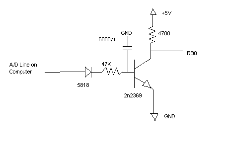

I can't use a pull up. The line I monitor is the A/D convertor line. I'm getting much better results with a 2n2369, but it's still not switching consistantly. The base is connected to the A/D line via a 5818 schottky and a 47k resistor and a 6800pf bypass cap. The collector is tied to my +5v rail via a 4k7, and the emmiter directly to GND. I've tried using formulas I've found on other sites to calculate the resistor values, but my problem is I just cant be sure what the voltage is on the line when it's tristated, so I used these values based on experimentation. I'm only concerned with detecting the negative edge on the line, is there a better way to do this?

Can you post a schematic? I don't understand your description.
Okay, here is a crude schematic of the transistor connections. The A/D line shown is tied between the computer and the PIC16F88.

What's the diode doing there?
If the input is push -pull then it will slow it down as will the capacitor; try removing them both.

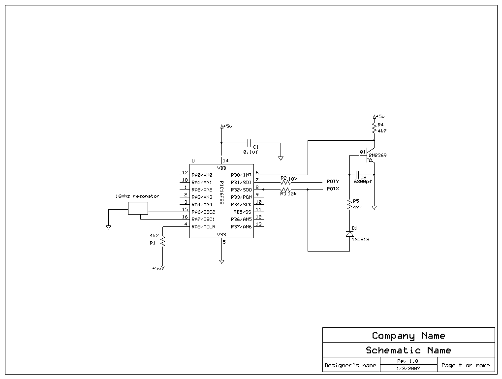

Here's my first attempt at using ExpressSCH. It should be of some help.
The POTX and POTY lines run to the control port on a Commodore 64 that are tied to an A/D convertor in a SID6581. The SID runs off a (roughly) 1mhz clock. It reads the POT lines in 512us cycles through an internal r/c. I'm trying to build a circuit that emulates a proportional mouse that Commodore built in the 80's. According to the device specs, this is how it should work.
The SID's read cycle begins by pulling the POT X and Y lines lo, to completely drain the caps, for 256us. The negative edge is used as a SYNC signal for the mouse to start counting cycles. At cycle 320+MouseX the POTX line is set from tri-state to hi, and at cycle 320+MouseY the POTY line is set high. At cycle 480, both lines are tristated, and the mouse waits for the next SYNC signal.
I'm having trouble with missed SYNC signals. A missed cycle registers in the A/D convertor as maximum resistance (127 in the computers POT register), so the on screen pointer jitters (from current position to 127, then back to its correct position).

Maybe some of the other guys here understand what you are trying to do, but I'm still in the dark. You're assuming that we understand what has been left unsaid. Are your mouse pots connected to +5V and GND? If so, how is this different from the original Commodore mouse? What is the role of the PIC in your circuit?
The POT X and Y lines run directly to the Commodore 64's control port, which is tied to the SID chip through a resistor and a capacitor. The convertor operates by temporarily grounding the lines (to drain the caps) then tri-stating the lines until the caps are charged. It measures the time to charge and stores the results in an internal register. The POT lines are intended for game paddles by design (just a variable resistor), but in the late 80's Commodore decided to make a proportional mouse (like serial or PS2 mice on PC's) that could be used on the C64 with special Windows-like software. The method I'm using to emulate it is how the mouse actually works. The key is to detect the start of the whole cycle, which is determined by the POT line going from tristate to lo at the C64 side. As well, I can't use a pull up because it would charge the cap inside the C64.
Would a comparator like the LM129 be a better solution than the transistor?
A comparator would probably be better. I can't see how anything that requires current, e.g., a BJT, can work.
So what does the PIC do? And how do the caps get charged? Are they charged from the PIC ports?
The PIC start counting cycles when RB0 is triggered (on interrupt) and sets RB1 and RB2 high at the appropriate times according to the desired POT values. Eventually it will be interfaced with a PS2 mouse and transfer its movements to the POT lines. The BJT does turn on from the low voltage of the POT line when its in a tristate condition, and switched off when the POT line is pulled low. The voltage on the line is very small, though. I believe its whats causing me to miss some cycles, when the transistor randomly fails to switch.
