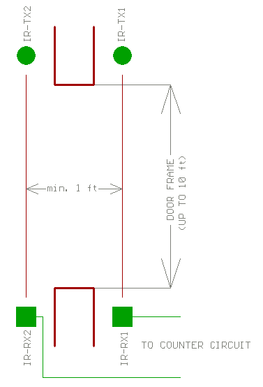

I didn't mean the door frame of 1 ft width, but the IR-barriers spaced at that distance.
Have a look at the sketch for better understanding.

I'd consider the fact that the beam must be at a height of approximately 1m to count persons. That's about the height chidren's eyes are.
A laser pointer has less power output and can already cause irreparable damage to an eye.
ir led is affected by ambient light ..
so how should i protect it
Using an IR-transmitter and a receiver (TSOP17xx series (Vishay)) ambient light has no effect.
The transmitter must not transmit continuously but pulse bursts on the receiver freqency.
This technique is used for IR remote controls (stereo, TV, etc.) without being affected by ambient light.
An exact description of required bursts is contained in the Vishay TSOP17 series data sheet.
