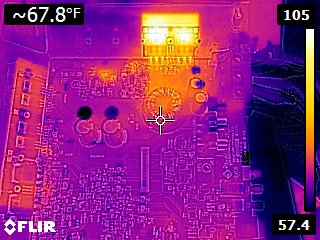

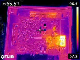

OK, more or less messing around with an old amp I had in the pile. Not even sure what the issue was with it but I threw some regulated power to it and it seemed to eat all the power I wanted to give it on the bench with no speakers or input signal. I rolled up to about 5 amps, then decided it would probably take all it could have so I better grab the thermal.
the FLIR image clearly pointed out a rather hot spot. Thinking "that was easy", I probed the mosfets and pulled em. Now I am second guessing what I am looking at, probably because I don't repair audio amps every often and don't fully understand them.
The FETs in the pic are 75344 power mosfets. Power it fed to them directly from input power. The issue is B+ is connected directly to the drain, and ground is plumbed right to the source....???? What am I missing here? You fire those dudes and you have a dead short..?
I sort of think I am on the right trail by following the hot spot with the thermal but not sure what to make of this. So far the mosfets seem good. No obvious short anyway.

It's probably a boot converter, to step up the 12V from the battery to a voltage that will deliver more power into an 8R speaker. Are you sure the B+ goes straight to the drain, or is there a choke (like the big flat torroidal near the FETs) in circuit before it? Also, is there a large diode in the area, wired to the drain terminal?
If they're getting warm but don't appear to be short, it's possible that this section of the circuit is working. Check for other voltages on the big smoothing caps. If you have a short power stage, it will be dragging down the output of your boost converter and overloading it.
Indeed! Pardon my ignorance as I don't get into these often. Purely a learning project. The Bat+ goes to an inductor, then to the drain of the mosfet. The neg goes directly to the other side of the inductor as well as the source of the mosfets. These also go to a double power diode pack with heat sinking to the entire case.

I did however find the core issue which would be a pair of shorted output mosfets. This is a 2ch amp so has two identical channels. One is good, one is not. The pair that is bad are shorted all over themselves. They are a 28N15 and 36P15. Comparing back and forth, it was an easy find. I was also inspecting the gate drivers and seems everything is still intact. Diodes and only a 10Ohm(?) series resistor? There is quite a trail of components for the gate drive so I would have to draw that one out. I sort of wonder if the OEM had failed transistors in mind though. Seems a common failure mode.
