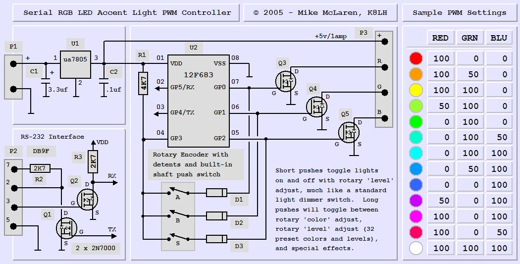

Oznog is right... Just three PWM outputs should do it... Then use a hefty power supply and drivers...
Regards, Mike
