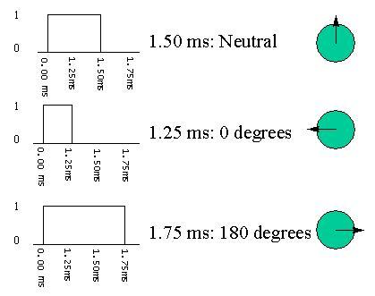

The thing is i would have paid more but we hav a cost limit to the project .But abt the project it is easy we need to 1st we need to give a pwm signal to the rc servo motors then read the adc values from each potentiometer then store into the microcontroller after tht we need to make changes accoding to value received i want the servo motor to move between 0 to 90 degrees according to the received value of the potentiometer. I would also like to knw how much money will u charge for making this project personally do let me know if u live in mumbai

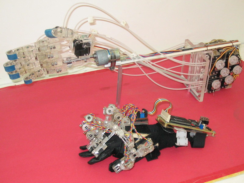

The project is about a dex hand project ill post u few pictures here abt the project and the pwm values

Why don't you contact the builder of the hand in the photos?
Dextrous hand by Andreas Maryanto

yeah it is his i am already in touch with him but hes kinda busy so thts why i am in a pickle he doesnt has the program cause his hard drive got burnt and 300$ is way out of my limit my limit is 180$ for the whole project cant pay 300 just for program

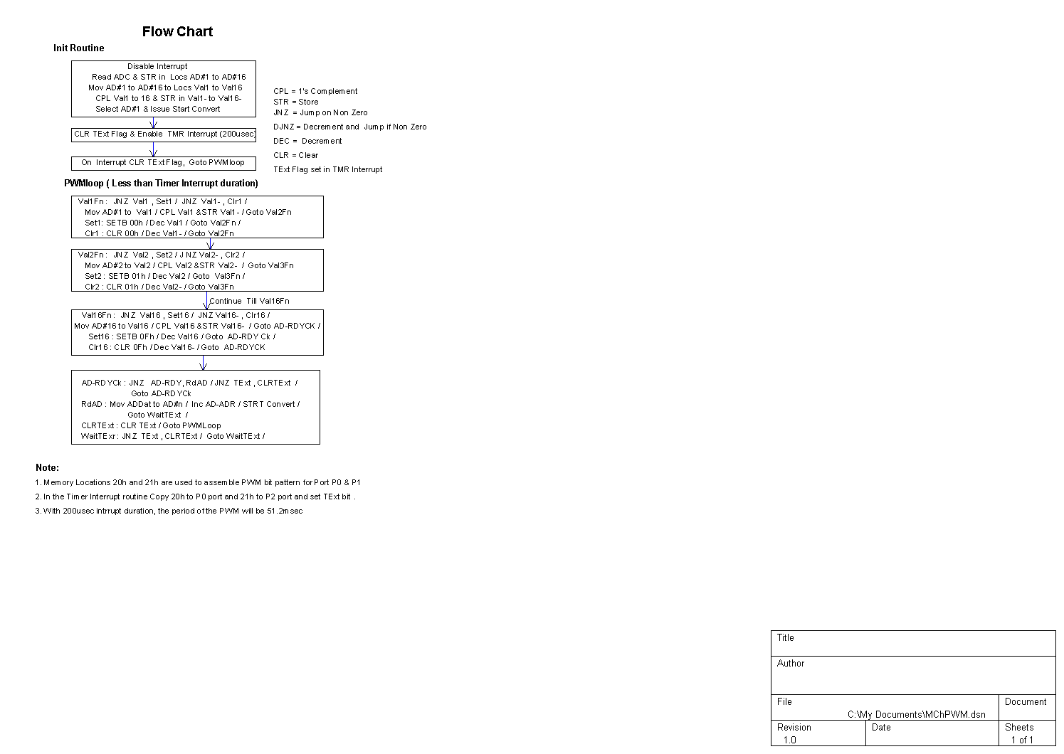

here i found somethign more see if this could help u out
You first load 00h to ports P0 and P2. Set for a long interrupt period of 18240 usec. During this period read all ADC channels and set up 16 pairs of registers with appropriate bit values.
On receipt of interrupt, change the interrupt to 32usec. For the first 39 interrupts load P0/P2 with 0ffh and for the next 16 interrupts load each pair of 16 register pairs to P0/P2. Go back to Reading ADC process from the beginning and repeat the cycle.
But not sure of it cause the time period i need it to run 50hz 20ms and the servos have to move between 0 to 90 degrees
