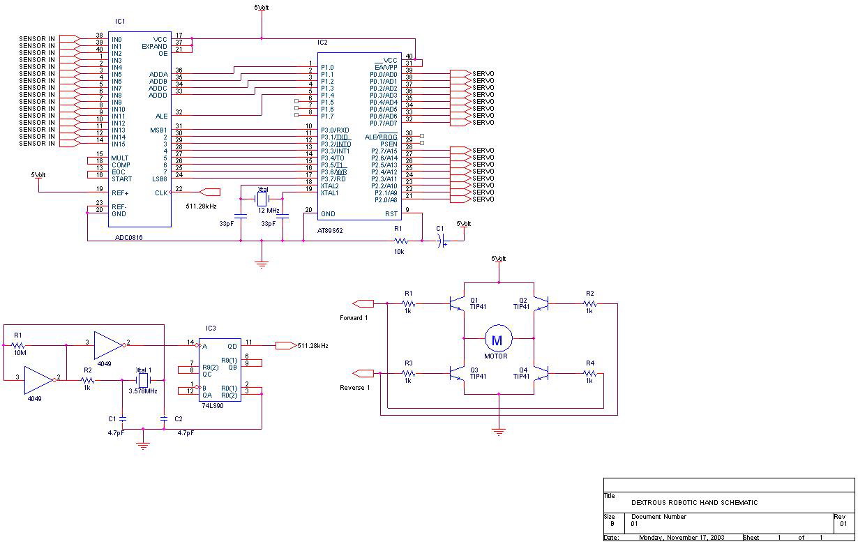

I am making a dex hand which works on an adc and AT98S52.
I dont knw how to program a ic i have the circuit diagram i just need help if some 1 could giv me the coding for it. There are 16 sensors (i am using 5k ohm pots as sensors) .The sensors are given to the adc the adc will generate a digital value and give it to micro controller.The micro controller will then generate a pwm signal .The pwm signal is then given to the servo motors. I basically need a program which will enable each servo motor to move according to the adc value received.Therefore each each pot will drive a single servo motor.

Hello divit, why have you selected an Atmel chip, are you familiar with it ? What programming experience do you have with this type of project ?
It seems you need to convert an analog signal to PWM to control a standard hobby servo unit, is this correct ?
This doesn't address programming your project, but you really want PNP transistors for your high-side units in the H-Bridge...
I am not familiar with it cause its my 1st project with micro controllers i am only 17 ,we are restricted to a very few micro controllers and also i can choose another Circuit but i will have to have somethign related to it cause i need to build a hand robot and that pwm signal is gonna drive servo motors
Saturn the H-bridge is for a seperate motor which i will change according to the motor il buy its not for the servos and i am also sorry if i havent mentioned in the tittle about programming .Would be greatfull if somebody could help me out
