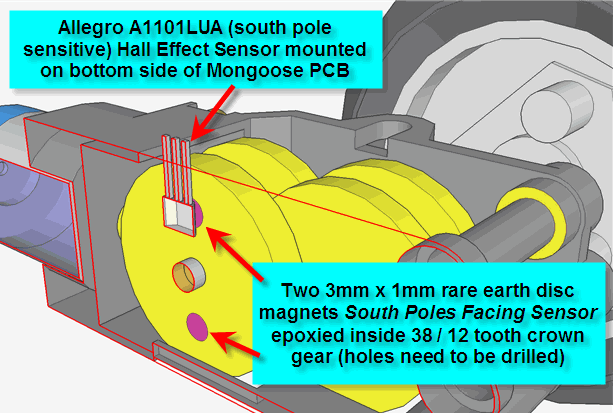

Found some 3mm x 1mm round rare earth magnets. Seems they might be just right for squeezing in to the crown gear (in the Tamiya Twin Gearbox)

Are the leads on the hall effect sensor going to be long enough?

The hall sensors have nice long leads. The will be mounted on the bottom side of the PCB. They are south sensitive only and those little 3mm x 1mm magents only have about a 4mm range, just right.
