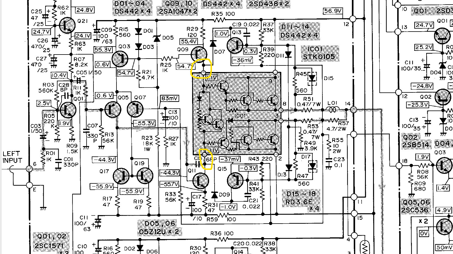

I have a vintage fisher rs-2010 that uses the "famous" stk packs. I get sound on both channels, but the rt channel has some distortion. My dc offset on good channel is 7mv, and the distorted channel is 32mv. That shouldn't cause my issues. Any idea where to start? Thanks
OK, think I found my issue. Q13 which feeds bad channel, has only .01v, should have .3, and q15 has same value. So Im thinking voltage is too low causing distortion. Thoughts? so change q13, q15? or something else?
So i have a short across b and e on q13, q15. This is with it in circuit. The matching pair of q14.q16 on good channel no short. Could q13, and q15 be bad?
Can you post the Q09 & Q11 waveforms from both channels? Also, what is the voltage between those two points with the amp idle? (for each channel).
Q13 and Q15 are part of the protection circuit. They are used to sense the voltage across the power stage output resistors (R51 & R53) and limit the drive to the STK is the current is too high.
They should read 220 Ohms between emitter and base while in circuit and unpowered, due to the base-emitter resistors?
Check the R51 & R53 output resistors are reading under one ohm and inspect the solder joints, make sure there are no cracks or dry joints?
If those are OK, you could remove or lift one end of D07 and D09, to isolate the protection part from the STX input drive. Just keep the volume very low to avoid any possibility of overloading the amp whilst unprotected.
Then check the collectors of Q09 & Q11 again & see if the output distortion has gone when checking with the scope?
It's certainly not impossible both transistors have failed, though it seems a bit of a coincidence. If it's OK with those diodes disconnected I'd definitely replace Q13 &Q15, and reconnect the diodes.

Q13 and 15 read a short across b and e, in circuit.So scope on q9, 11?? How? Sorry, I'm very new with this, and a scope. Thanks

d07,d09 lifted, still have bad output on speaker out on that channel.

q9, q11 still have an odd waveform compared to q10,q12 on clean channel, with the diodes lifted. Where is this signal going bad. GRRRR
The two yellow junctions I marked on the diagram, earlier - you say you are seeing different waveform there between the two channels; can you post photos of the waveforms you see, for all four points?
Also please measure (DC voltage) between those two point, in each amp channel, with power on but no signal?
Thanks. Still trying to figure out this scope. It's an analog tek 2235. I have to change the v and ms when measuring anything besides the speaker output. It's definitely challenging for me
Soldered everything back in. I'm thinking my scope trigger is whacked, or its me. I adjust it, get wave out of speaker outputs. When i test inside, it varies, and i have to change volts div, and sec div. Not sure if that's how it should work. I have some voltages for you, those are easy.

Whilst the D07 & D07 were out, Q13 & 15 could not cause a problem; leave the diodes out and forget them for now - the problem is to the left of those, in the circuit.
You have not given the voltage measured directly between the two yellow points for each channel; that is critical.
Leave the scope set for AC coupling and it should work on the same setting for speaker or the yellow points.
Post photos of the waveform on the yellow points, both channels?

Sorry. As I said, I'm lost. I forgot those other voltages. So voltage from d07 to d09???one leg on each? 2.15 volts across. And I don't understand to the left. the left on the schematic?? That ac setting helped big time with the scope. I just assumed to use dc. So i narrowed down the bad signal to R37. Its bad on one side, not clean. Thats where I get the ugly wave. I don't think that tells anything though. LOL.
The diodes should still be disconnected, so between the junction of Q09 collector to the STK and Q11 collector to the STK.
Looking as the schematic diagram, the audio signal flow is left-to-right, input to output.
The protection circuit (Q13 / Q15 and the components connected to their bases etc.) works right to left, but as long as those two diodes are disconnected that is isolated and should be ignored, as the problem is still there without it.
Q13 & Q15 need attention eventually, but are not the cause of the distortion, if the problem remains with D07 and D09 disconnected - so leave the diodes out and forget that part until after the main fault is found. Just keep the volume down until we get back to that & fix it.
If you see the distorted waveform on the at some point and the input signal is good, then the fault is either at the point you are looking at, or nearer the amp input; to the left, in the schematic.
The yellow points I marked are critical points - the transition from normal, easily replaceable components to the STK0105 hybrid. If the fault is before those (in the Q09 / Q11 circuits or nearer the input / left), it's easily fixable - otherwise the STK needs replacing.
That is why I want the voltage between those points and the waveforms at them.
Ok, will remove diodes and retest. I'm wondering if it's just easier to swap out the stk with a spare? I'm a bit busy rest of week. I will update when I get a chance. Thanks for all the help, and explanation. It's definitely a learning process.
So new stk, and replace q13,q15???
Yep, that sounds about right.
It may have had a severe overload on that channel somehow, enough to destroy the protection transistors & then take out the STK module?? Or the transistors went by chance and the module had no protection.
