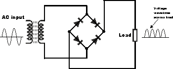

The magnetic field from the "sending" coil can induce AC voltage in another _coil_
The two coils work as a transformer, but are not physically attached to the same core - just in close proximity.
http://en.wikipedia.org/wiki/Transformer
Rectifiers - diodes - are like "one way valves" are with liquids - they only allow current flow in one direction.
Four diodes suitably connected route the AC input so you get the same polarity output for either polarity of input.
http://en.wikipedia.org/wiki/Diode_bridge
From an AC input, you get unsmoothed DC out the rectifier; the output voltage drops off as the AC reduces and changes polarity, then increases again during the next half cycle.
A capacitor across the rectifier output "smooths" the variations and gives a steadier voltage.
A rectifier is just a type of diode intended for use in power circuits, rather than for small signals like audio or logic.
Bigger, in other words, rather than being fundamentally different.

you need a second coil as a "receiver" (called the "secondary" of a transformer), and the diodes are connected to the secondary coil to change the high frequency AC into DC. the amount of voltage and current available on the secondary side depends on how much voltage and current are used to drive the primary side. the power (in watts) is calculated as E*I (voltage times current), and will be nearly equal when compared between primary and secondary. i said nearly equal, because there is always a slight amount of loss. if you drive the primary side with 10 volts at 10 amps at 40khz, and the primary and secondary have the same number of turns of wire, and the primary and secondary are really well coupled magenetically, you will be able to get 10 volts at 9 amps out of the secondary (assuming efficiency at 90%... you will never get 100% or more, it will always be less than 100%) to drive the load. you can change the ratio of the turns of wire between the primary and secondary to get more voltage (add secondary turns) or less voltage (subtract secondary turns) and the current available from the secondary will be inversely proportional to the voltage. so you could get 0.9 volts at 100 amperes with a turns ratio of 10:1 or 100 volts at 0.9 amperes with a ratio of 1:10.
Awesome thank you!! So by connected rectifying diodes I can convert the current from AD to DC. Thank you that clarifies things. And I just need a coil of wire (the secondary) situated above the the oven coil (primary) and not connected to the primary - and then connect diodes to the secondary and boom there we go?
Yes, boom there you go.
The left coil is the 'RF driven coil' from the induction cooker; the right one is the 'RF inducted coil' ; the dots are the air gap coupling space between them; rectifiers make RF into pulsing DC; posterior filtering can smooth waveform.
The ratio of coil turns sets the secondary voltage.
