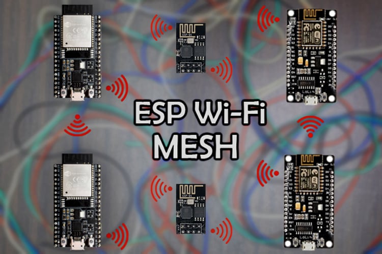

ESP32 create a mesh network. Module includes RF facility, some users have
extended range >> 1 KM.
