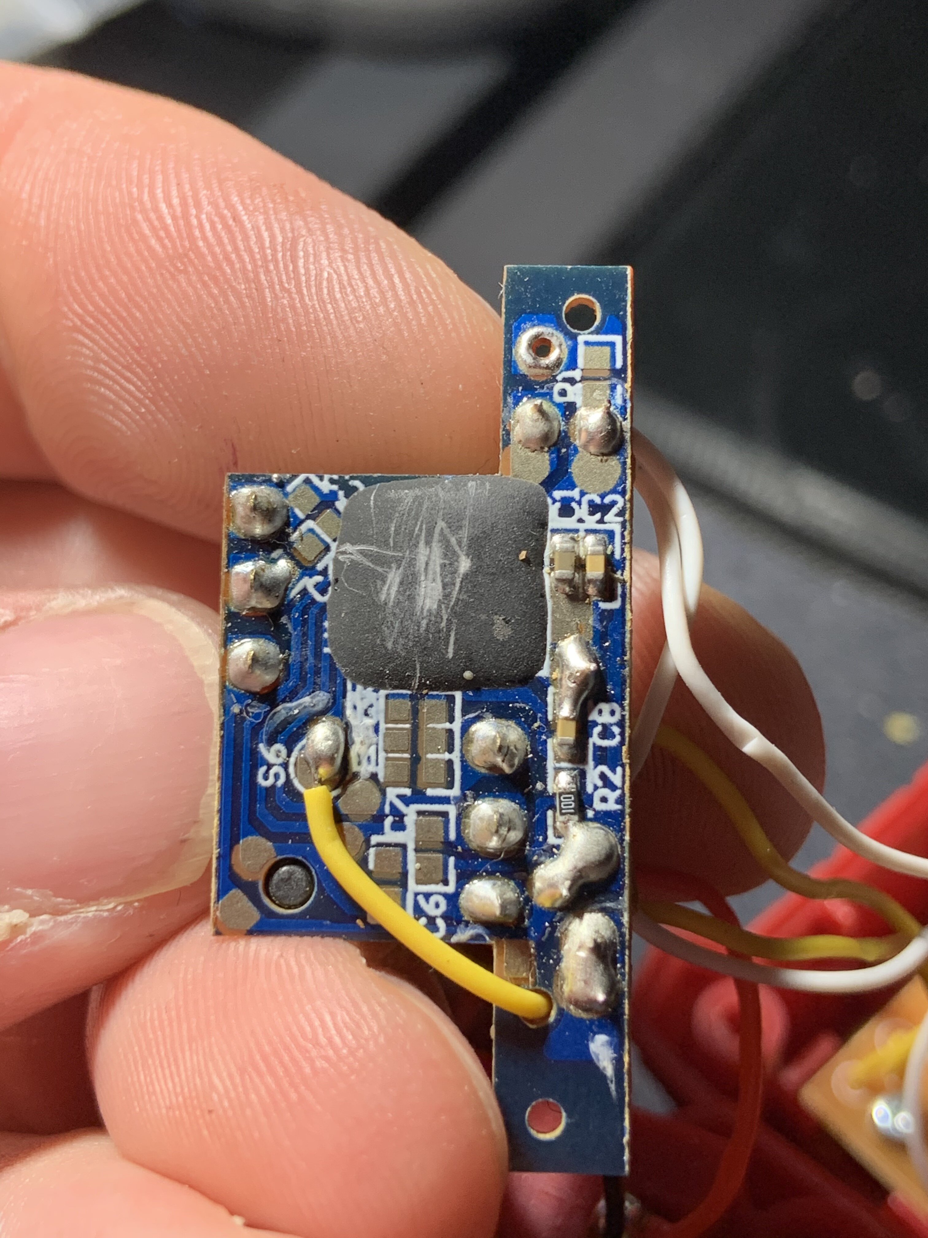

Hello everybody. I have a little issue hopefully some of you can help me with. I would like to add some features to a PCB and I cannot find any information on it. It is a Power FX pack from Hasbro for the Avengers series action figures. I have attached some pictures to better understand what it is. I would like to add some voices to it that are triggered by different DIP switch pins. I have a few programmers that could be used for this but I just need a little direction. I have a few Arduinos, a CH314 and a few others. Does anyone have experience with something like this? Also before anyone says anything about copyright stuff, I did contact Hasbro first:

Sorry, I would like to see if I can patch into the programming pads on the PCB and flash it. I dont think even a NANO would fit in it. Its pretty cramped.
there are two possibilities. first the chip is probably "mask programmed" which means theres an etch mask use during the fabrication of the chip that makes the programming permanent, or second, . the chip is programmed through a JTAG interface, and the jtag pins connect to the test pads on the board. one thing you probably won't be able to identify is the chip itself because it's mounted directly on the PCB, the bond wires are bonded to the board and the chip, and then the thing is covered with a blob of epoxy. programming, if done by JTAG is done on a "bed of nails" fixture, where the board is pressed down on pogo pins, and held by some type of clamp. the pogo pins supply power, interface with the JTAG port, and there may be other pins for testing the functionality of the board at the same time.
It's unlikely to be programmable at all - it's the cheapest possible device (as required for a mass produced toy), and the COB (Chip On Board) is almost certainly actually manufactured with the required audio already inside it.
As always in these type of cases (it's a regular question here) the best solution is probably a tiny MP3 player module, that plays from a microSD card.
yes I'm with the other 2, the chip is either burned from new or its a one time programmable, even if it is programmable you have no idea what device it is and what protocol it uses.
If you were to design a board you might get an arduino processor board down to that size, and possibly get a sd card on it too, but it'd be tight.

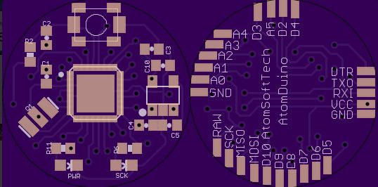

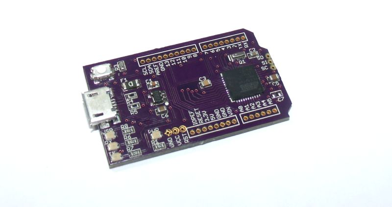

Ive made tiny arduinos... but dont sell much since virus outbreak... If needed you can order one from me:
or
That might solve your size issue. The code portion is up to you tho.
