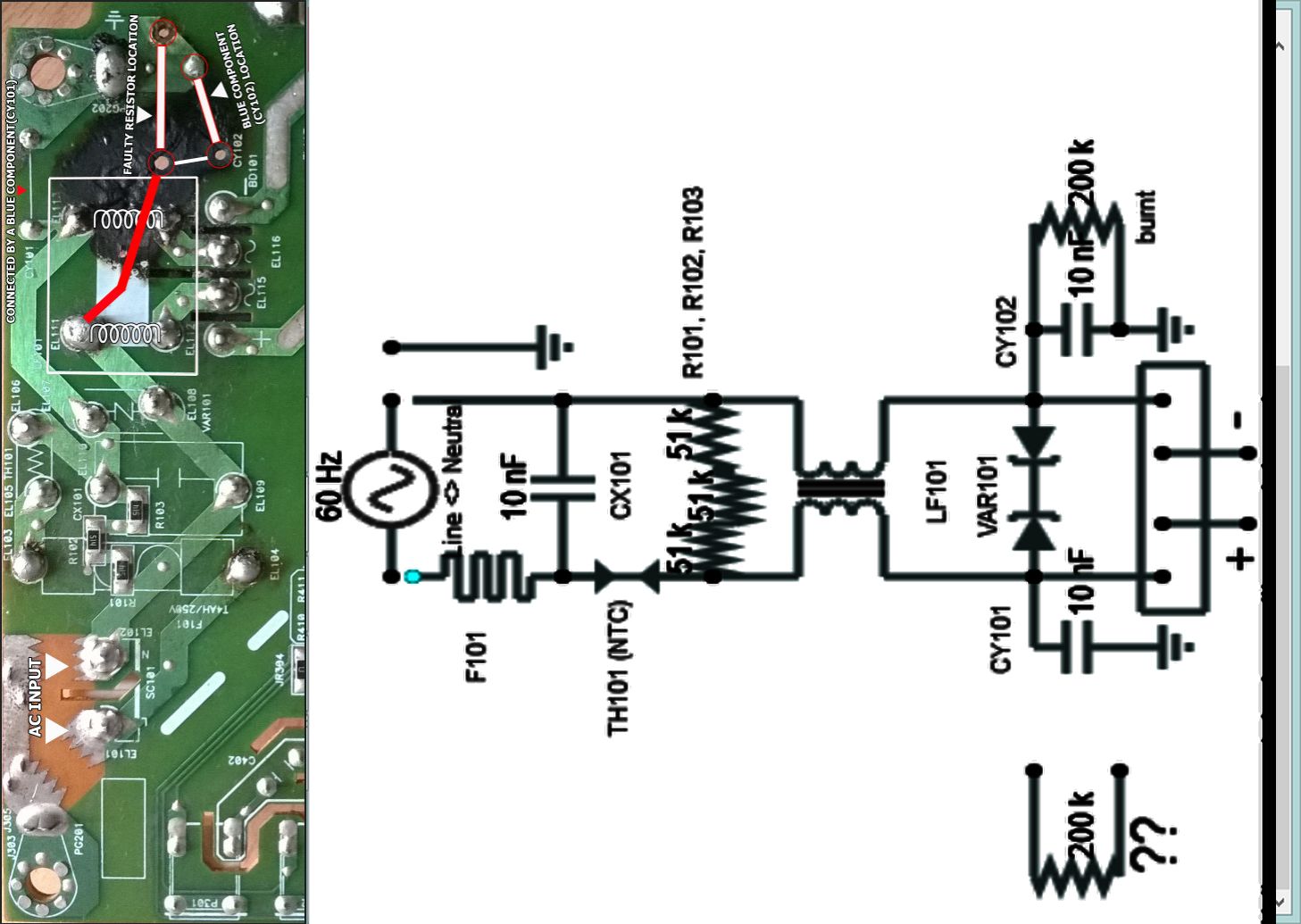

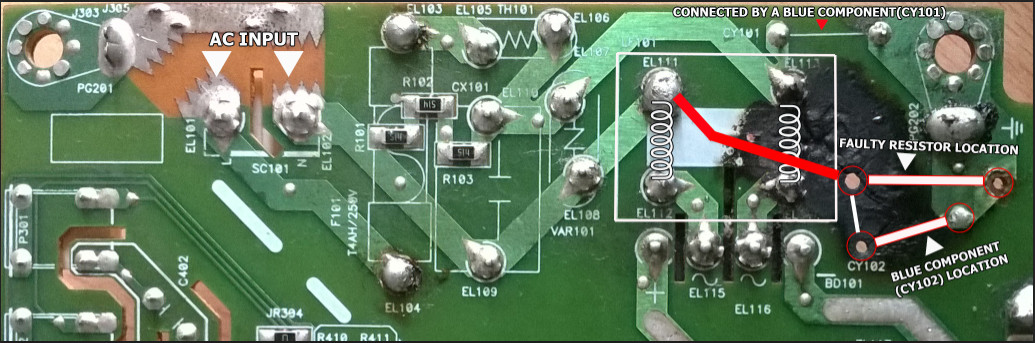

resistor frequently blown
Tony Stewart when it is replaced it work for four to five days only. Afterward it burnt with smoke, display disappear and cannot start.

Here I tried and reconstruct the damage circuit

Assuming the red line accurately shows a PCB track, then CY101/102 are safety capacitors, and the resistor is a high value safety resistor - just checked a few satellite receiver PSU's and they all use either 4.7M or 10M, with capacitors varying from 1nF to 4.7nF.
But this resistor won't stop it working, with it removed the unit will still be 100% functional, it only provided a high resistance static path back to the mains, and thus to earth.
If it doesn't work with the resistor removed (and it shouldn't be a low value anyway!) then you have a fault somewhere preventing it from working.

It's unlikely the circuit is available, you're probably supposed to just replace the entire PCB - for the short time that replacements are available.
You don't need to fit a high value resistor, just leave it out (for fault finding purposes), and the two capacitors as well if you want - none of them affect the operation of the set in any way (they just provide a leakage path to earth for any static build-up on the chassis).

As others have said this failure should not stop the item from working. There must be another fault somewhere. The fact that this resistor is burning out is potentially dangerous as the antenna connector may be connected to the chassis. (It could also be isolated from the chassis with capacitors.) Due to the potential danger from the fault I think the OP should either get someone with more knowledge to look at the fault or replace the power supply board.

Yup, I agree with Nigel, those should simply be a static bleed resistor and low value caps. Looking at the first photo though, that blue "cap" thing looks a lot more like a varistor to me than a cap, which if that turned out to be the case, would be causing bad things to happen :)
Considering there is no power between Neutral and ground and maybe 0.5mA, a schematic error is the only thing that makes sense as suggested in #22
Pls explain how this burns up a resistor unless Line and Neutral are reversed,
EDIT
After reviewing photo.
It is clearly only for line filter caps & safety Y2 cap and bleeder R (10k)

Nigel Goodwin according to your suggestion i fixed up without the resistor and the blue component, its working fine without any problem! but there is strong current with the antenna. should i replace with 500k ohm resistor?
I stand by my original comments. This is not a power resistor, but it will blow with a lot of power if Line and neutral are reverse wired in house. even if TV is correct with 3 pronged plug.

Putting 120V across a 10K R used to bleed a Y2 Cap would certainly do that and still work as a TV unit with SMPS isolation but noise interference. This could only happen if Line & Neutral were reversed unintentionally. ( DIY wiring by someone)
This is how I would show schematic. Feel free to correct any assumptions.
NOTE: CX101 means it is an X rated Cap line to line.
CY101 means it is a Y rated cap. Common mode to ground
Burnt R can be 200K 1/4W
Cap must be film Y rated for the Y rated position.
CY101 makes the antenna slightly hot ( < 3.5mA)
edit... ( but only if you got no safety ground and a miswired AC outlet. )
