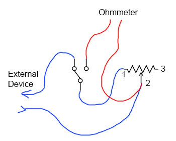

Hello,
I'm not sure if there is a practical solution to this problem, but maybe someone can can help me with this.
I'm using a 200 ohm trimmer to test a certain device. It's not relevant what the device is, but basically I need a variable resistance and I need to be able to measure or check the resistance at a certain point. I bought a 0-200 ohm integrated panel ohmmeter from ebay and I use a 9V battery to power it.
I could use a switch to check the value of the resistance. When the switch is pressed, it disconnects the external device and connects the ohmmeter. Like in the following picture:
But I would really like to make the circuit so, that the ohmmeter shows the resistance constantly. So that I don't need to press any buttons.
Is there a way to do this? I've also measured the resistance from points 2 and 3, but then I have to subtract the result from the total (200ohm) resistance to get the resistance the device sees. I wouldn't like to do that either. Is it possible to measure the resistance from points 2 and 3 and make the ohmmeter show the opposite resistance?
Thanks for anyone who is willing to help :)
You are placing an external resistance across a "device" and likely adjusting that external 200 ohm pot until the device does something. At that point you measure the resistance that the device did something at. My guess is that whatever the external device is that device is passing a current through the external resistance. Should that be true rather than an ohmmeter you could use a voltmeter and measure the voltage drop across the external resistance as you adjust the pot. Your circuit example does not reflect a battery buy you mention using a battery? Looking at your drawing the external resistance is either in series or parallel with something in the device. If this is some sort of a go or no go test then what you are doing is the only method without knowing much more information.
If the device affects any current through the trimmer then it is relevant, since an attached Ohmmeter will give a misleading reading for the trimmer resistance.
Alec, I agree. It looks like, from his drawing, he adjust the pot till the device does something (whatever it does) and then the device is disconnected from the pot and he measures the pot's resistance that was applied to the device. Regardless, I really dislike the magical mystery tour. :)

The mysterious "external device" is a device that measures skin impedance. As I found out few days ago, it does this using high frequency ~80KHz signal with less than 10mA of current. I do not know how constant the voltage or current is when the load changes.
This test box would be used to test that the device alerts when resistance gets very low (almost short) ~5 ohm and when resistance gets too high, 135 ohms. This is how it's supposed to be tested, with a potentiometer. I am just wondering if a potentiometer is fully resistive at 80KHz? But as I said, this is how it's supposed to be tested :)
If the device works at higher frequencies and the ohmmeter at DC, could I filter these two signals with a large enough cap series with the measuring device and an inductor series with the ohmmeter and make them work at the same time?
I bought a 0-200ohm panel ohmmeter from ebay. It hasn't arrived yet and the spec sheet doesn't cover much. It does have a pot for zero adjustment.
I've never known skin resistance to be that low. Presumably the distance between probes used for the measurement is extremely small? If the 80kHz signal drives 10mA through ~100Ω, that implies a drive voltage ~1VAC. I suspect that is going to upset your Ohmmeter if you intend connecting that to the working skin tester. Also, the 9V supply for the Ohmmeter may well upset the skin tester. I think you will have to settle for using the Ohmmeter to check the pot setting only when the pot is disconnected from the skin tester. Disconnection would be necessary when the skin tester is in normal use anyway.
Yes the electrodes are close to each other.
It seems so. Thanks for help anyway :)
