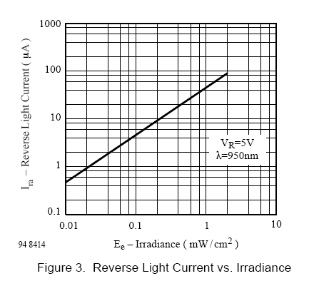

Ok, the attached is right off the BPW41 datasheet. Note that at nominal illumination levels, the current through the diode will be ~10uA.

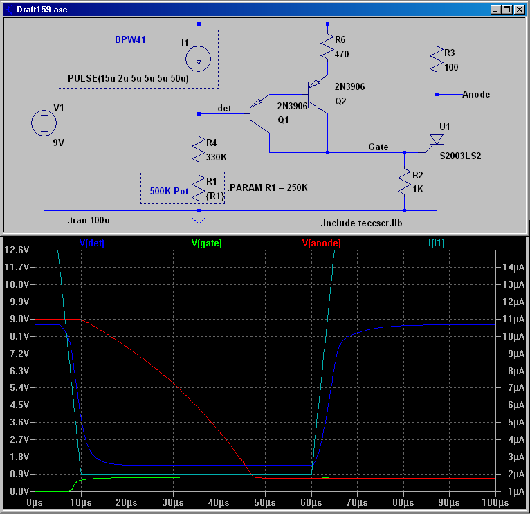

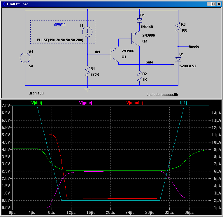

Here 'tis. I'm assuming that when illuminated, the BPW41 puts out 15uA; 2uA due to the ambient light while the beam is blocked. You should confirm that using a 5V supply and a uAmeter connected in series with the detector.

Can I be a complete pain and ask a further couple of questions on that - firstly, what would need to be changed if it were a 9v supply? (I ask because I have a whole host of equipment that will be running at the same time from a 9v supply...)
secondly, would it be possible to swap a variable resistor in at either R1 or R2 to make sensitivity adjustable? I'm told this is highly beneficial!
Here it is:

Mike, shouldn't you add a gate current limiting resistor?
R6 does it. Because of the resistor in the emitter, the Darlington acts as a constant current source.
