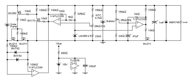

Glad you guys cleared your misunderstanding. The charger is a trickle charger charged by a solar panel. So the 1N5819 diode can be used, right ? The circuit is attached below just in case. It is designed by someone named Oscar.

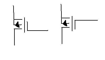

ps. I have a quick newbie question, what is the difference between the two MOSFET symbols in the second attachment ?
Thanks !

The two BAT diodes are just to clamp the input to the op amp to about +/-0.4V.
The two MOSFETs are the same type, ref drawing, just drawn that way for convenience..
The 'arrows' direction on the FET's indicate a different type.
I would also connect one of the inputs of the unused comparator to +15V and the other to 0V.
There is an object lesson here. The lesson is, most noobs post too little info, rather than too much. If you had posted the schematic in the first place, we would have told you to use 1N4148's. The 1N5917 is one of the poorer choices for this application, although it should work.
