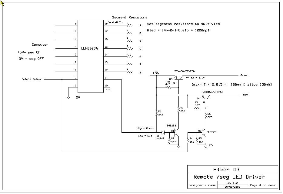

I cannot rely on the USB +5v supplying the current necessary to light all the LEDs in the segment displays. The anode circuit is much more complicated than I supposed.
I thought that I could connect +5-12v to pin 10 of the ULN2803A and the anodes to pins 18, 17 and the USB +5v control to pins 1, 2.
If you look at the schematic in my first post, the relay is controlled by a BC547C and a 1N4007 (the LED and resistor are optional). It seems to me the relay coil could be replaced with the LED anodes, could it not?
The design covers all the points raised in your posts of yesterday.
Decimal point, computer buffering of the anode select, ability to individually select anodes, long cable runs, operation from +5 volts.
The anode select is the simplest I can think of one transistor and two resistors.
Perhaps other members reading this could come up with a better design.

What is pin 10 of the UNL2803A used for? You used it in the schematic of a previous post here.
Also keep in mind the the power to displays can be adjusted to a range 5v to 12v if it simplifies the design.

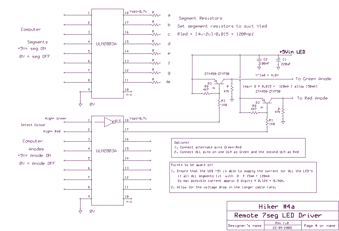

The cathode switching circuits using the ULN2803A works great. However, I have the components connected on breadboard for this anode switching diagram and it is not working as expected. Please help.
I am just testing one anode circuit, using pins 1 and 18 of ULN2803A. When I do not apply +5v to pin 1 of the ULN2803A the LED segment is on, and conversely, when I do apply +5v to pin 1 the LED segment goes off. So my results are the opposite of what I expected.

The ULN2803 is an open collector [darlington invertor].
When +5V is applied to pin 1 then pin 18 should go low [0.7v], this grounds the base resistor of the PNP transistor and switches it ON, putting +5V on the collector of the PNP. This +5V is the Anode supply to the far LED's.
Check that you havn't reversed the ZTX pins..:)

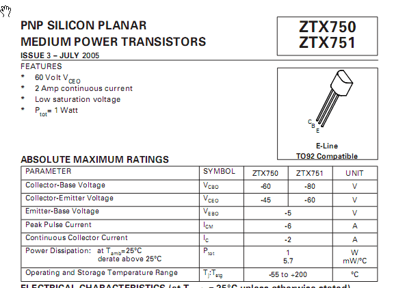

I've checked and rechecked and even reversed the connections to test. According to the datasheet for the ZTX450 it is a NPN transistor not a PNP. Is that the problem, and if so, what PNP transistor should I use?
I can see whats happened, it was when we were trying to find alternative transistors, I have misread the ZTX450.
If you recall the original type was ZTX751 which you couldnt source.
You require a PNP of the ZTX series that can run with a 200mA collector current.
If you can say which types you can get, I will suggest one from the list.:)

The ZTX750 is the one I had trouble sourcing, previous post here. I can get the ZTX751, my source is here. Should I get the ZTX751 and use same circuit, just substituting the ZTX751 in place of the ZTX450?
Also do I need the capacitors, and if so, why?
The ZTX750 and 751 are the ones I use. Pity you are not in the UK, I could give you some ZTX751's.
You do need the caps for noise decoupling, BUT you only fit one of each to the incoming +5V line, near to the ZTX's .
Not two caps for every ZTX.

If I need to increase the voltage to drive the LED segments to make brighter, say to 6v -12v, will that change the resistor or other values?
OK, one more question please...
If you want to make them brighter and you increase the voltage and increase the resistors you will not get any improvement in brightness.:)
Just increase the drive voltage slowly from 5V until you get the required brightness.
The ULN will have no problems and the ZTX is rated to about 1Amp, so its just your power supply and LED's, dont exceed the rating of the LED's.
