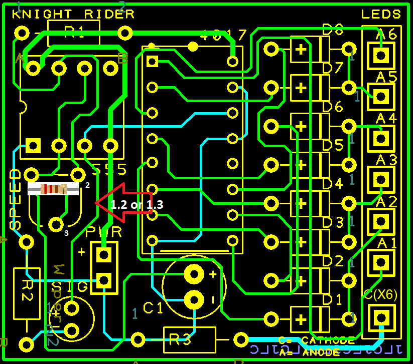

What would i need to to to this PCB to make this work with just a fixed resistor?
Meaning i want to remove the variable resistor and insert a single fixed resistor in its place.
Thank you in advance
This is my current resistor (225k)
Wanting to replace it with a 100k 1/4 watt
In this circuit the resistor adjusts frequency.
You need two resistors, no?
Im still pretty green but i thought i was doing this right before i posted but no matter what pins i placed the resistor across i could not reproduce what the pot was doing. Turns out i mis-read the resistor value. instead of 100k i was using a 1k. Well, it works now. As it should.

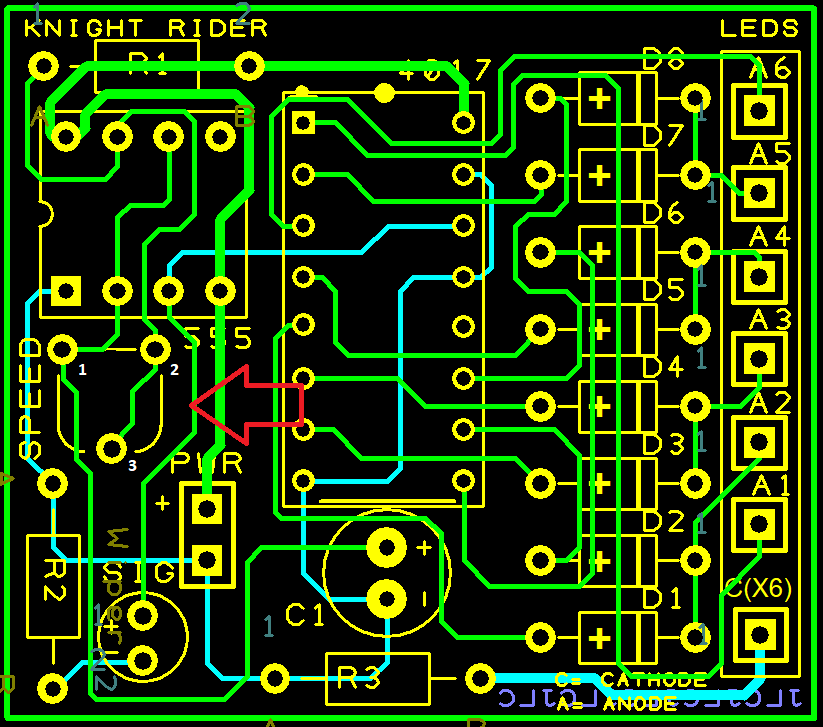

seems logical and i did choose 1 to 2 but there is a trace from 3 to 2. so would that still leave an open circuit?
Post #7 was perfectly correct, 1 and 2, OR 1 and 3, as 2 and 3 are the same point.

It makes no difference, but from a purely cosmetic point of view (and if it will fit) then place it between 1 and 2 (so it's aligned with the other components). I'd also like to see the tolerance band at the same end as R1 and R3 (assuming they are both the same way round).
If it won't fit (neatly) between 1 and 2, then it may fit better between 1 and 3, as that spacing looks to slightly be wider.

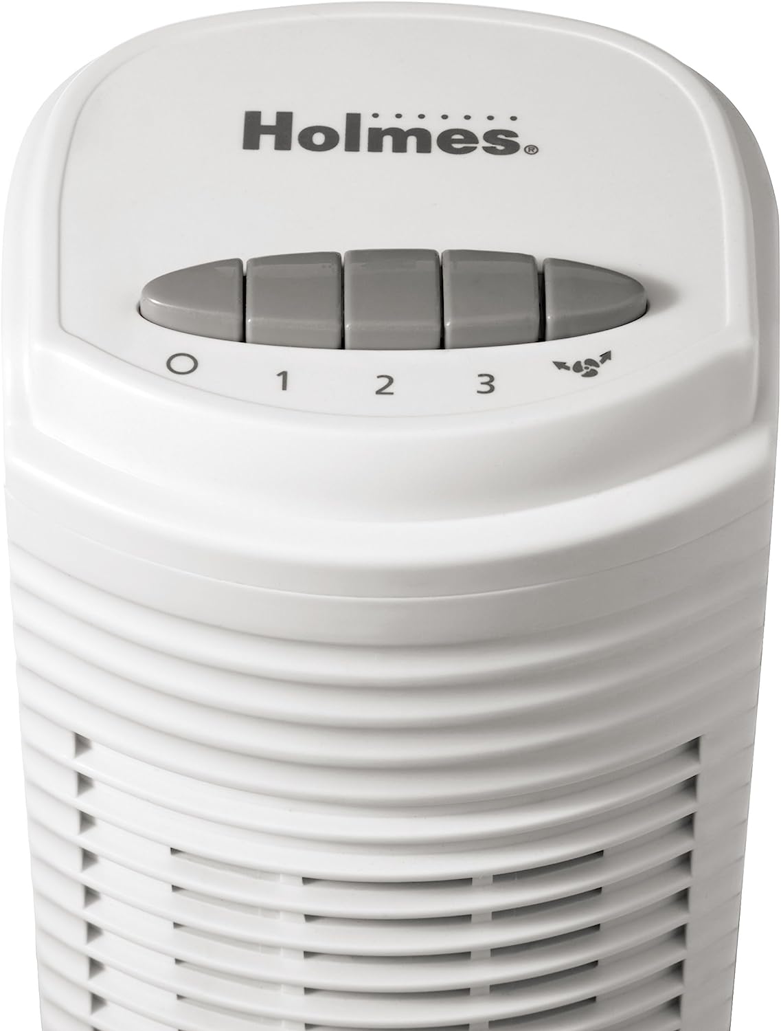

The 30x40mm circuit will be placed inside the housing of a fan. The kind of fan that tall and narrow. instead of blades it has a long squirrel cage to move the air.
It had push buttons to control the speeds and i ruined them while cleaning with brake cleaner. I never seen anything like it. within seconds the plastic buttons and housing began to crumble in my hands. Research proved that that product does indeed do this. since that incident i now have tuner cleaner on hand.

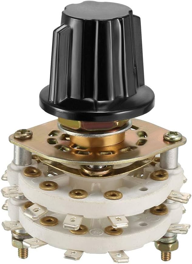

The new switch is a this 4p4t rotary style

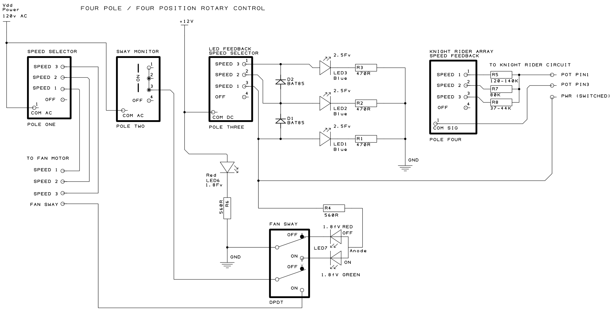

I need this switch to not only control the fan speed but to monitor the fans sway feature as it can only be engages if the fan is running. here is the schematic for the switch.
Pole 1 (AC) is the fans speed. Pole 2 (AC) monitors the sway feature. Pole 3 (DC) are feedback LEDs for the fans speed. And pole 4 (DC) is also feedback for the fans speed where the knight rider circuit will progressively increase / decrease based on the fans speed. Now the resistors will be located on the switch and pins 1 & 2 OR 1 & 3 will be replaced with a plug or header pin.
