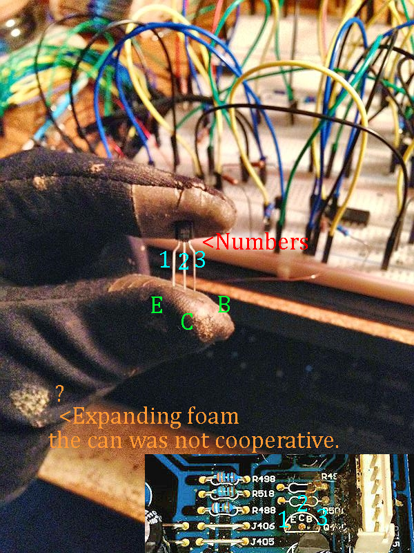

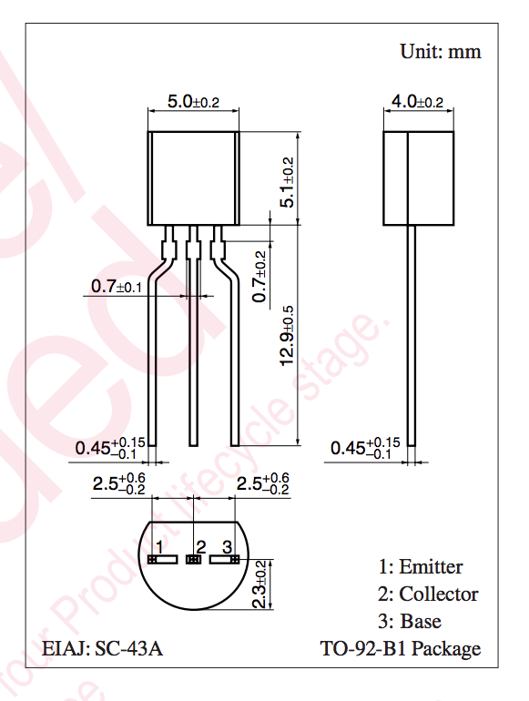

Also the Panasonic by the datasheet states pin 1 Emitter, pin 2 Collector, and pin 3 Base. It carries the same pin out as the 3206 that was removed.
Interesting question regarding the new Pan Transistor - Don't hurry and feel you need to respond fast.
I can put this Pan Transistor in last.
When looking at the data sheet for the Panasonic Transistor:
https://media.digikey.com/pdf/Data Sheets/Panasonic Semiconductors ICs PDFs/2SC1473(A).pdf
It's either misleading or wrong in terms of what side the Base is on because in the bottom section where it shows the half circle shape it indicates with the round side facing me that base (3) is on the right. Even though I heard that the flat side with writing on it usually indicates left to right.
I was just testing the new parts, and realized I didn't want to install the Base on the wrong side.
I did a test with the flat side facing me (side with writing on it), and put the positive lead on the right (Base), and put the negative lead on the collector and emitters, and got a reading for both...
Collector + Base = .596
Emitter + Base = .612
The other way around with the round side facing me the same test showed no reading.
What do you think?
The reading states correct for NPN type pin 3 as the Base. An image just to give an example, with the letters facing person.
Side note, on quite a majority of BJT type transistors, the Collector reads the lower value vs the Emitter. Base set point of the transistor for the N channel leads the Collector into operation, thus shorter path of Base to collector (less resistance), the Diode path to emitter results the higher reading (more resistance). P channel also, however the values on PNP type are usually closer in being near equal readings from the base as the set point. Overall transistors based on type and design can vary.

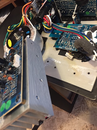

Actually, I diligently got all the new parts installed (tested the signal along where their destinations), applied the grease, and before assembly
saw on the bottom of the sync, there was a need to apply grease there (pic), so did that as well. Glad I had enough left in the tube..
I brought it outside the house with a power strip, flipped it on, and it turned on with no issues.
I got excited and brought it in my office and rigged up the other powered monitors, got my breakout box and mac fired up to
play, turned it all on...
I heard the subwoofer and the other powered monitors fine :).
I then turned up the volume on the sub pre and I heard a little sound (poofish sound coming from the sub speaker not the inside).
That was it, no more sound coming from the sub woofer.. Still powered with clean expected sound coming from the mains) nothing exploded or caught on fire.

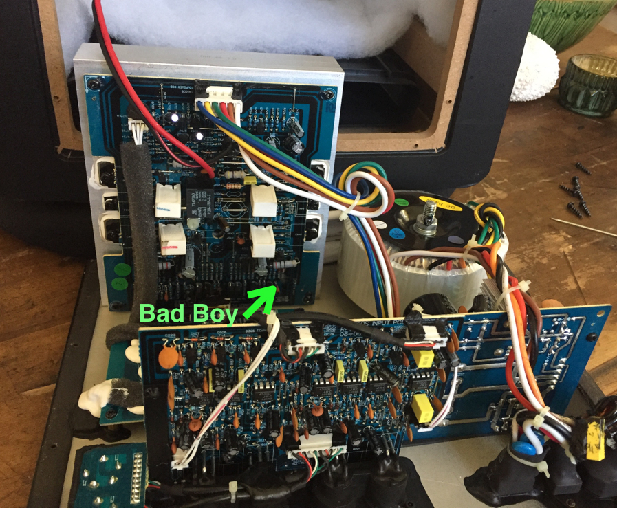

Right then, The board could have damage parts else where, That diode that was cracked may be some point of interest. well then, good luck on the job search.
Yes, good point. I will take it out of the box to do an inspection, and take a few pics in case the
immediate damage is visible.. Snap shot in history if you will. Thanks for the good luck wishes.
