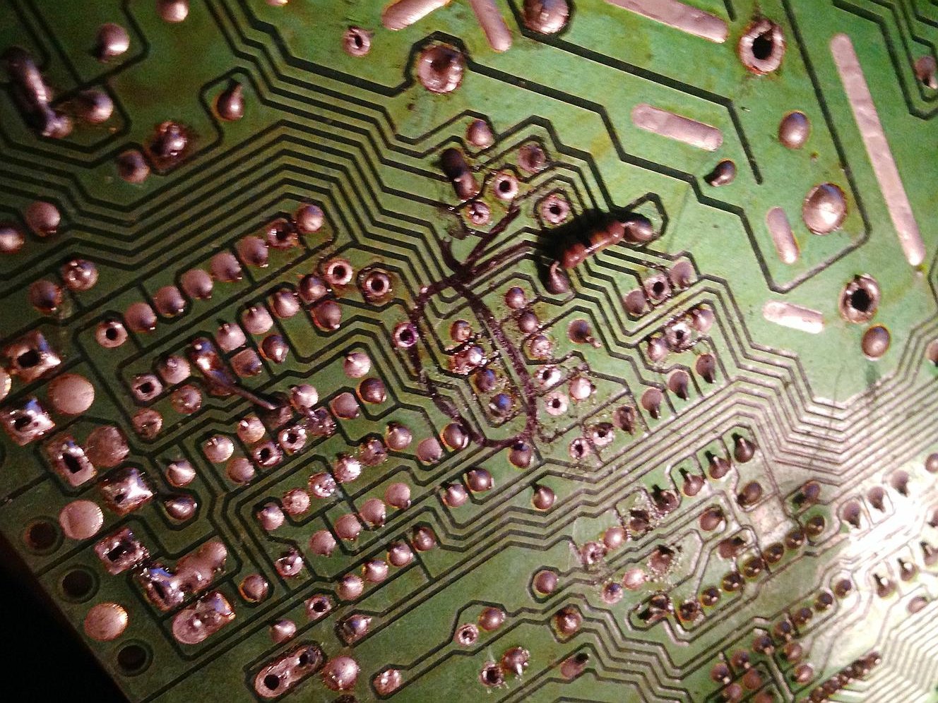

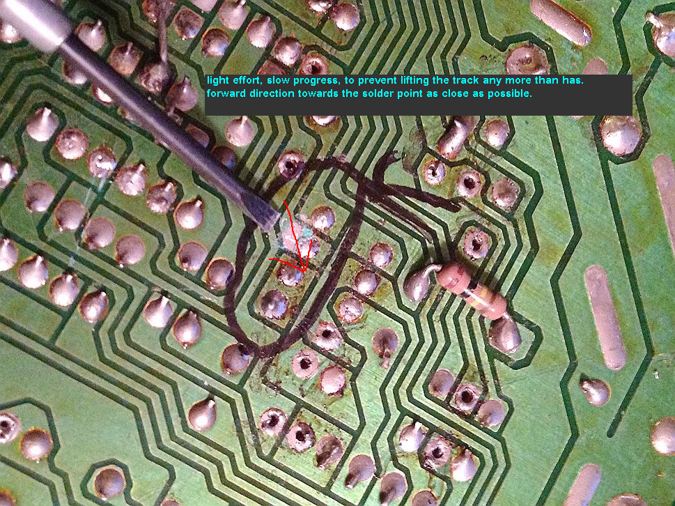

OK. a moment to allow me to get my itinerary together and plot the board, that image helps a great deal. and as for the damaged tracks, yes sometimes they do lift, however, as long as they are up to the connection point solder patching is simple. Just requires a light scratching of the coating near the track point and then solder the new point with good part. I am going to provide images on this by using a junk board that I have parted out. If that would be ok? (on the how to repair those tracks)
Sure, I'd appreciate that. Conceptually all we're doing is laying down solder for continuity basically right?

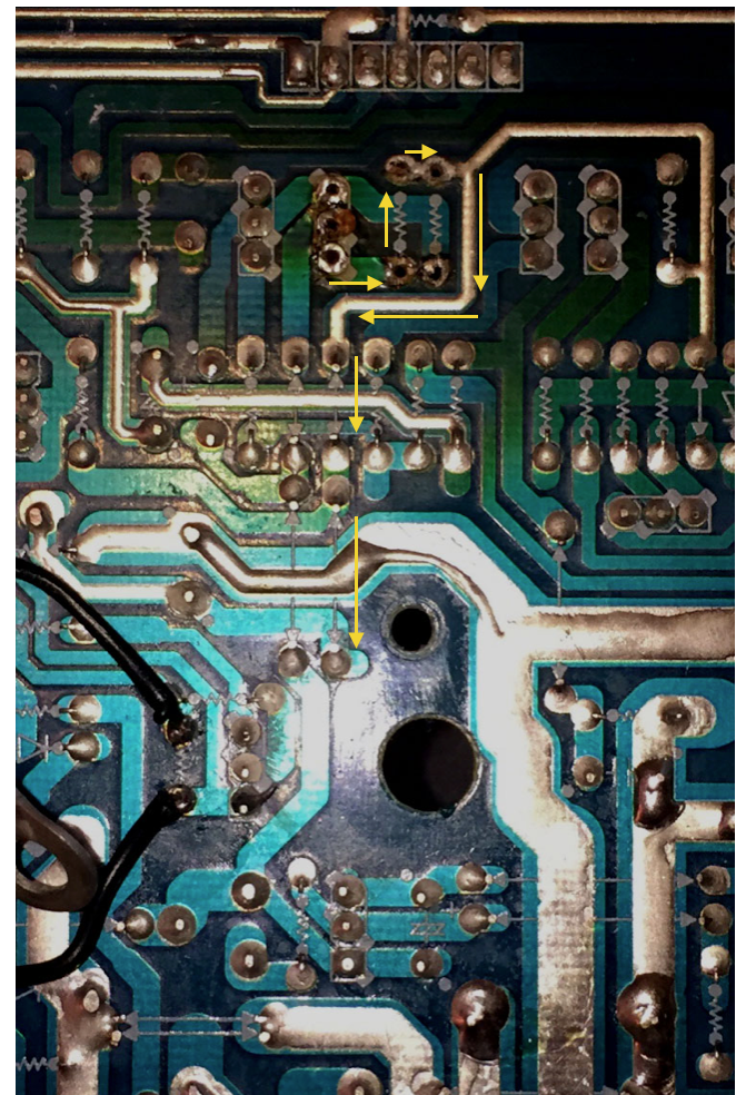

I looked on the other side to follow where E goes, and it appears to go straight to the nearest blue resistor, then that connects to the other resistor, and then travels down the outside line, and straight to your "Or Like this" location...
Bingo, this is an easy part, the E tracks do not go directly to signal processing other than the bad 3206 C. The collector goes to switch Q438. this is a signal switching transistor and the Panasonic is a very close switch replacement. the over all config does look to be an on statement switch to power part of the signal switching array for the power processing parts. As now I can see that the bad 3206 Emitter does not go anywhere other than the blue 68 Ohm resistor. Overall as long as Q444 is ok, the replacement should reactivate the amp and board.

The replacement parts thus far are the Panasonic transistor 2SC1473A (Digikey)
the resistors at close as well are the two:
68 Ohm Mouser part 279-LR1F68R TE Connectivity brand
1K Mouser part 279-LR1F1K0 TE Connectivity brand.
the resistor leads can be carefully bent to get them to fit if they have more length than the originals by a margin oversized. The new transistors leads may be straight and require slight bending below the safe range limit at the bottom of the transistor itself. I can provide info on how to if needed.

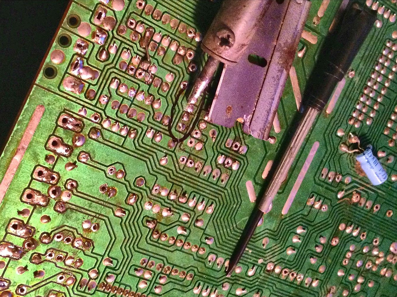

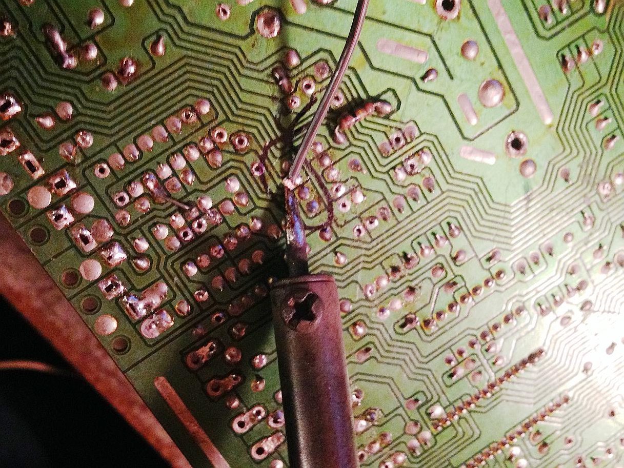

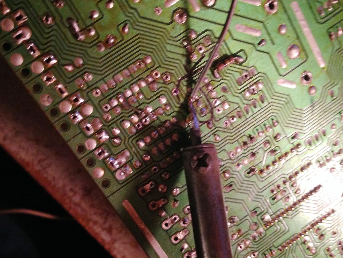

Photos, all be it a bit shaky. I'm still developing that third hand from my head holding the phone all ways pulling pranks on me tho...hmm:hilarious:
If you have to, solder a lead from one of those corroded resistors, using a clean lead from one resistor from the parts side to the solder side. to help hold the track down to clean off the coating.
Then the light scraping will have less effect on possibly lifting any more track.

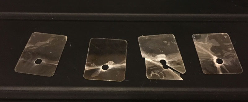

Those are plastic, or a very thin Mica plate, the stress marks indicate thin mica. and no, I would not advise the reuse of them. because those stress points can brake during snugging of the screw on assembly and allow potential a short even with non conductive grease, as the transistors heat up, that grease becomes malleable (soft like a fluid gel -pliable) and can ooze away allowing a metal to metal contact short. And the broken one, did it come off like that? or was it stressed then broke rather easily after removal?
As for the wire used, that will be ok, as it only enables the field produced by the board in operation to be absorbed so to speak to a close by return point. That large block of aluminum would act as an overgrown antenna, holding a low charge, especially from being any where near that speakers magnet, and the pcb being so close, this field would play havoc on near by components that were sensitive to it. Transistors primarily in general have an amazingly low static transfer rate, until energized or connected in a shielded manner. The manufacturers method is just to use a gnd plane for return. As long as the leads reach, and able to be installed, and are not too long, as this could bunch up between the board and sink, it will work fine. As for tinning the ring leads, would help to increase the transfer, tho not really needed. As for tinning to help then hold together better, that would help, however I have not seen if those leads (Oring) would be kept away from the other contacts on the power pcb when everything is assembled together.
Actually I was having difficulty after removing the screw getting it to lift off the aluminum heat sync, and I broke it on lift.
I'll look for replacement Mica plate material..

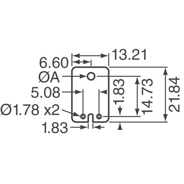

Mica, possible pieces, as for their thickness, those from that amp are thin, good heat transfer, the ones here https://www.digikey.com/product-detail/en/4672/36-4672-ND/27401?WT
These may be thicker, less heat transfer, the datasheet spec states the small holes at lower are for the transistors pins, in your case those can be left as is, if they are large enough to be correct, or trim those 3 small ports off. High temp tho by said datasheet. 1100 deg F. An .003 to .001 thickness. means they vary in thickness. this is not a realistic problem really, as I doubt you'll try to run them in a Class D 1000Watt and above heat range resulting in thermal off Bias..:)

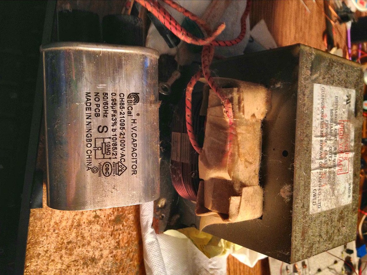

that wallmart appears to be (all tho I can not for some reason see the images on that site) for Microwave ovens, the Magnetrons antenna cover plate, allows the frequency through, but helps to reduce some temperature (minor) and signal latching back to the Magnetron resulting in a quite impressive boom (major). note some 900W microwaves can be close to 20,000 Volts and higher (not so much current tho) only be referring to the capacitor for the transformers phase usually at the do not exceed 22,000 V. :EDIT: just a fun factor add in about things that could be unexpectedly dangerous in the household:
And yes that is a poor made cheap capacitor, just stating that for any that may chime in about its country of origin.:wideyed:

those Keystone do fit a variety of transistors, however, no data yet exist that I have oh those 4 Transistors on the sides of the power pcb. here is the spec for the size of the plates themselves in measurement term. Measurements are usually in millimeter, but the datasheet seems to state p inch thickness terms, over viewing this datasheet.
these have indicated for 220 case, that would be those smaller transistors in between the needed larger transistors.
