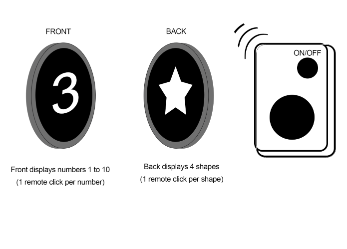

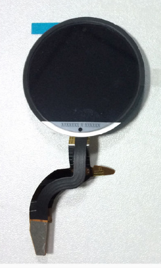

I ultimately want to find a way of using the attached circular display (approx 1.5 inches) as a display that can store 10 images that can be changed by remote control (one click of the remote displays the next stored image). The circular display must not be physically connected to anything storing the images.

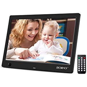

I understand that photo frames are available on the market (picture also attached) that use this technology and was looking for a way of combining the two.

As long as you can get the technical data on the display - eg. what type of internal driver IC it uses and what signals it needs - it should be quite possible.
I have a prototype of a product on my bench right now that uses a 1.8" full colour LCD screen, with a DSPIC33 series microcontroller feeding it with graphics. That's displaying a user interface, mostly text plus small icon images, but there is no reason you cannot do the same with full screen images.
You can store a number of images in the internal flash memory of an MCU such as that (the one we are using has half a megabyte of flash), or also have an interface to an SD card and read images from the card for display, as with the photo frame type units.
That allows many gigabytes of storage for images, depending on the SD card in use.

Attached a mock up of how it would look. The two circular screens would go back to back and would be on a necklace with the screens looking like a pendant. Both screens would have separate remotes.

You can do it with 8 bit PIC's as well, particularly the 18F series. I've had a number of simple 'picture frame' examples running feeding various different sizes of TFT displays - the trick is to convert the pictures to the exact resolution of the display, and store them as non-compressed BMP files. Obviously you have to store them in external data storage, an SD card makes the ideal solution.
Displaying JPG files takes MUCH longer, and a great deal more processing power.
So he needs the display, a processor, an SD card slot, a remote control receiver (of whatever type he wishes), a power supply, the various interconnecting circuitry, and a big chunk of software.

Because the screens would essentially have to look like a pendant on a necklace it would mean it couldn't be attached physically to any external device. So would an SD card with the images on and a bluetooth receiver for each screen suffice?

This is what Im trying to find out. The displays will only have to be on for about 1 minute at a time. Would cell batteries work? Here is the link with specs http://www.lcddisplaymodule.com/sal...d-display-1-39-inch-amoled-module-screen.html
what if we take 2 galaxy gears cut off the wrist band and glue them back to back , not sure if they can display photos though?
Yes sorry, coin cell.
You'll have to contact the manufacturer of the display. There is no info on the current draw.
