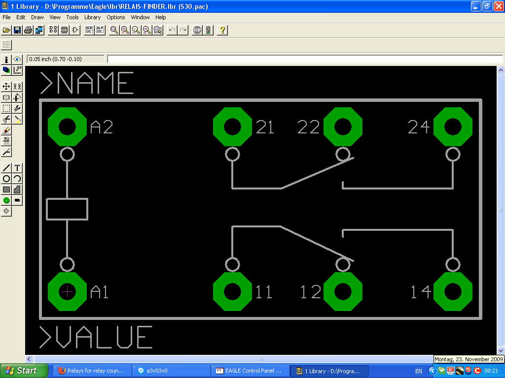

you might want to use relays with standard pitch of 1/10". The FINDER S30 fits exacly onto a DIL16 socket and is affordable as well.
That kind of relay is made by many manufacturers - so you don't have to purchase FINDER relays.
The advantage: A burnt up relay is easily exchanged when using a modified DIL16 socket (with excessive pins removed for easy trace routing)

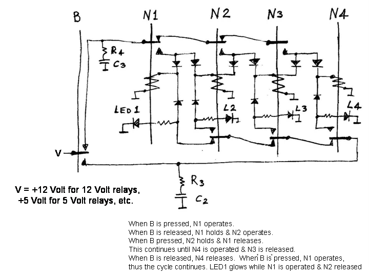

Here is a relay counter & 2 relay FF circuits.
The FET used with the FF is required to do a "make before break" function.
Otherwise, the FF may not work since a SPDT contact goes open while in transit.

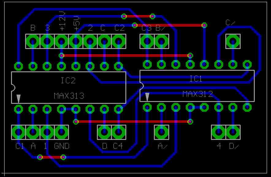

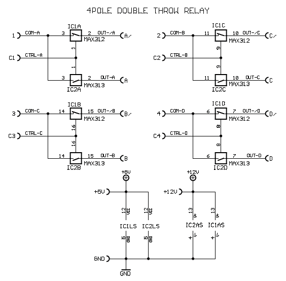

Yet a silent and cheap solution. For a four-pole double throw relay use one MAX312 (NC) and one MAX313 (NO). Connect all four control pins (1,8,9,16) instead of a relay coil.
The MAX312/313 can stand 100mA switching current at a voltage higher than +5V (separate +V pin)
Here are a schematic and a board design suggestion. Control pins must be connected for common operation of each pair of switches. Board size is 1.835X1.2inches.
Looks like "break before make" to me.
Whereas, a SPDT contact is break before make.
That's exactly what you would expect a relay to do.
"Make before break" could sometimes have fatal consequences. :)
The result is important. What happens before throwing relay conctacts is no point of interest. (except for unintended shorts). :)

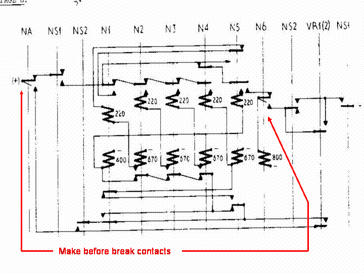

Many years ago, I worked on the design of complex relay systems for electromechanical telephone exchanges.
There were "make before break" contacts available that were used to prevent race conditions.
There were also "X" and "Y" contacts which were designed to make first (X contacts) and make last (Y contacts). These were also necessary for timing reasons.
The counter I posted above is a simplification of a counter that was used in telephone exchanges to count pulses from the telephone dial.
The attachment is a copy of that counter, copied from a training manual. It counts 1 ~ 10 pulses. For example, after 3 pulses, N3 will be the only relay operated. But after say 8 pulses, N3 & N6 will be operated.
Note that relays N1 ~ N5 have 2 coils. One was the operate coil, the other the hold coil. In my version, I used diodes instead as I don't think you can buy dual coil relays now.
The NA relay repeats the dial pulses to the counter.

On some relays it's possible to convert a break-before-make contact set into make-before-break by carefully bending the outer contacts towards the common contact. They have to be bent far enough that when the common contact is in mid-travel position, all three are touching. When the common contact reaches its full travel, it draws the one contact with it breaking the other contact.
