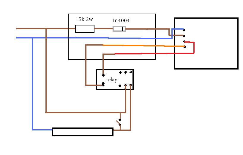

yes i have 15k resistor then 1n4004 with the cathode to the right like on the diagram have i wired this one wrong?

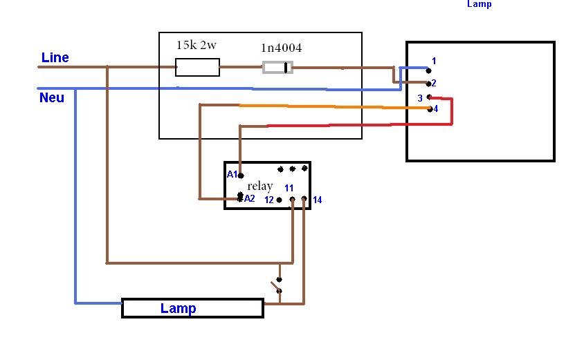

If you have the 'bar' mark of the diode as shown in the diagram , thats correct.
Also you should have the Line input to pin#2, via the resistor and the diode and the Neutral to pin#1
Do you have a picture of the Timer wiring that I could see.???
The Timer unit should work without the relay connected, it should give some indication that is powered up.
Are you sure the Timer is a MEU11 or 17.???

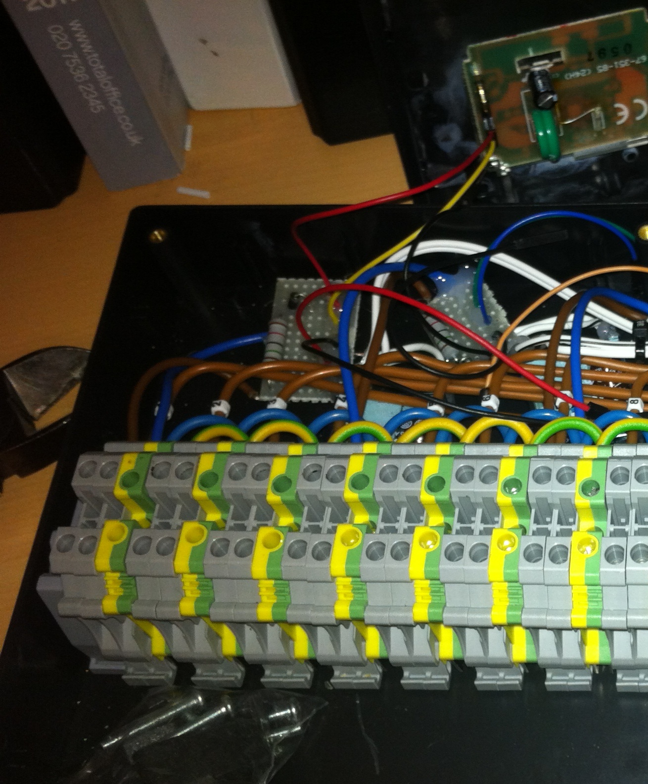

meu11 and i had it wired line to pin 2 neutral to pin 1 the diode is the same as picture and i will try and get a picture but where i have placed it isnt easy and my solderings not the best so it doesnt look neat lol
if i cant get these timers working is there any other small timers that will do the same job switch 230v lighting
this is the best pic i could get i dunno if you can make it out

does this help?
hi Jak,
Sorry but the image doesn't really make clear how its connected.
Have you tried just the basic set up as shown in fig#6 of the Timer datasheet.?? , using the 15K and diode and relay as shown.
The Timer should show signs of being powered up, on the front panel, ?? Let me know what you see.

Did you at any time reverse the diode or connections... I have to ask
no but the thing is i have 4 of them and all 4 are not working so that makes me think it must be me? i will draw out what i have done.
this is just a quick paint picture but is exactly what i have done
Checked the fig #6 numbers against the drawing you posted, looks OK to me.

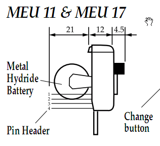

On fig6, it shows pin4 nearest to the PCB edge, is that how you have it wired.??
i dont understand what you mean but in all the fig's it shows that pin 1 at the top of the unit and it outlines the shape of the unit so you can tell what pin 1 and 4 are so they are correct but i just cant understand why im not getting anything on the screen of the unit
Like this image, from the datasheet.
I would contact Rapid technical support, from re checking the data sheet and your drawings the Timers should work
