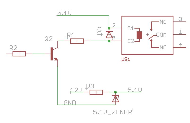

Ok would it be sane and safe to control a 5v Relay using a 5.1v zener with a 12v supply ?.. For instance...
I have some of these:
https://www.electro-tech-online.com/custompdfs/2013/06/en-g5le.pdf
5 VDC 79.4mA relays
so should i do a 100mv / 80mA to find the resistance and use a resistor? (1.25 ohm) to limit the current to 80mA ? Or will the internal resistance handle that?
Kinda lost but seems like a nice cheap way to control a Relay using 7-24v .... :)
FOR EXAMPLE I DREW THIS UP: (EDIT FIXED RESISTOR FOR ZENER)

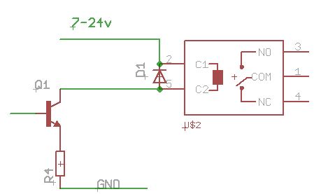

I have often used a simpler method.
The transistor base connects directly to the logic level pin, and when relay is ON the base is at about 4.5v.
Then I use a resistor from the emitter to ground. That acts as a constant current relay driver;
base = 4.5v
emitter = 4.5v - 0.6v = 3.9v
emitter resistor = 3.9v / 80mA = 49 ohms
After that the relay coil (with its diode) are connected between the PSU positive and the transistor collector.
It won't matter if the PSU is at 10v or 24v, the relay coil (when on) will always get 80mA.
Just remember the transistor will dissipate the dropped voltage and may need some heatsinking, although that is still a better option than dissipating the drop on a little zener.
Ok to clarify that in my mind you mean like this:

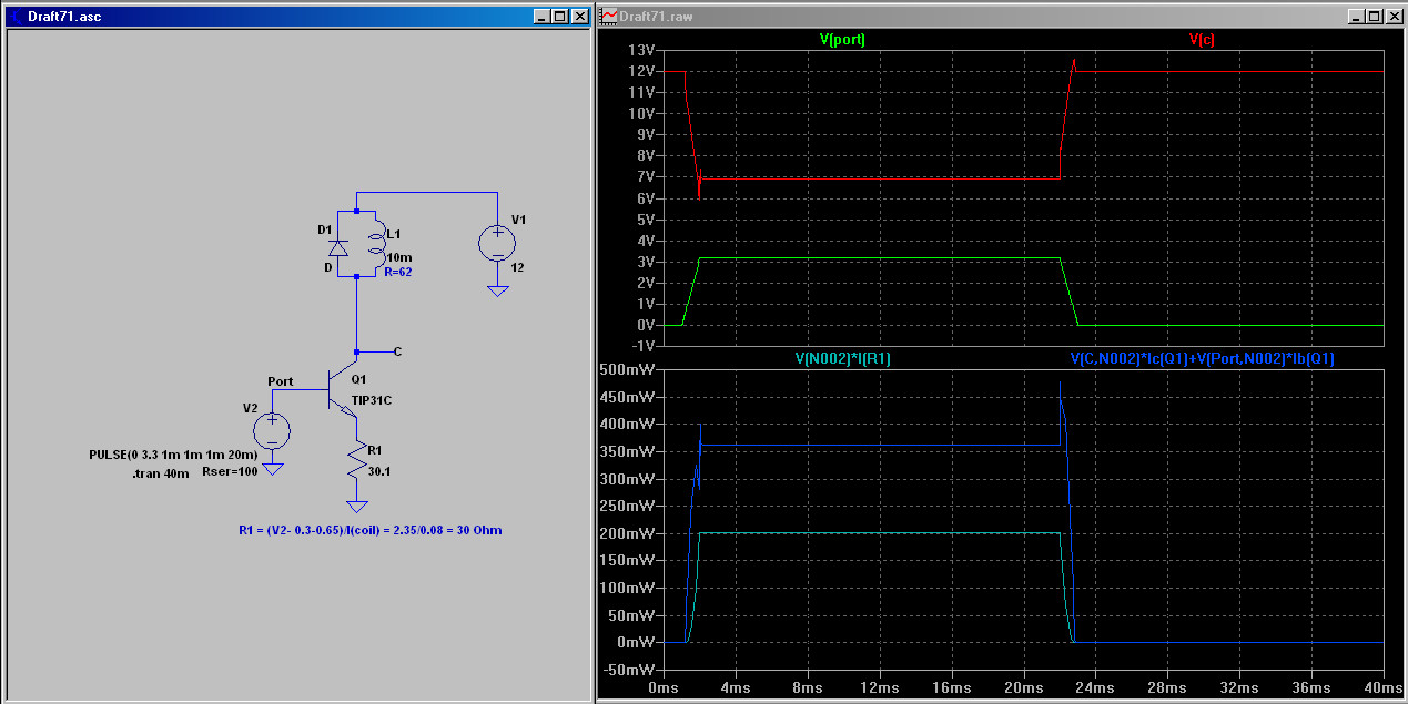

Here is a schematic taylored for your situation. The port pin swing is 3.3V. The auxilary power supply is 12V. The relay coil resistance is 5V/80mA = 62Ω.
R1 sets the current per the formula shown. The voltage across the relay is 5V. The power dissipation in R1 is shown in lt. blue (use either a 1/2W or 1W resistor), and the power in Q1 is shown in dk. blue (use a heatsink on Q1).
The minimum voltage at V1 is 8V. The dissipation in Q1 when V1 is 24V is a whopping 1.5W. Bigger heatsink.
